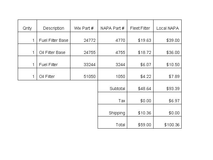

The NAPA filter is the right one I was missing the stop inside the canister that's why such a big filter I image. The previous owner tried a fix with a couple of washers. They were lying in the bottom of the canister. I am going to order a spin on conversion for the fuel filter for the next time. I am going to order an oil filter adapter also. I found FLEETFILTER.COM and can order the conversions and filters for about $50. This morning I am going to NAPA to check on their prices and pick up some oil and a couple of brass fittings.

On Sunday I went to the NAPA store here locally to compare prices for the listed items. FleetFilter.com is actually a NAPA store in TX. They ship by UPS. I made an order today, I will tell you how long it takes to get.

Got everything today was waiting on the porch from the UPS man. Everything is NAPA. Filters and housings all match, even the oil by pass filter has the small orifices and all. Better than expected especially at the price. Will definitely do business with them again.
