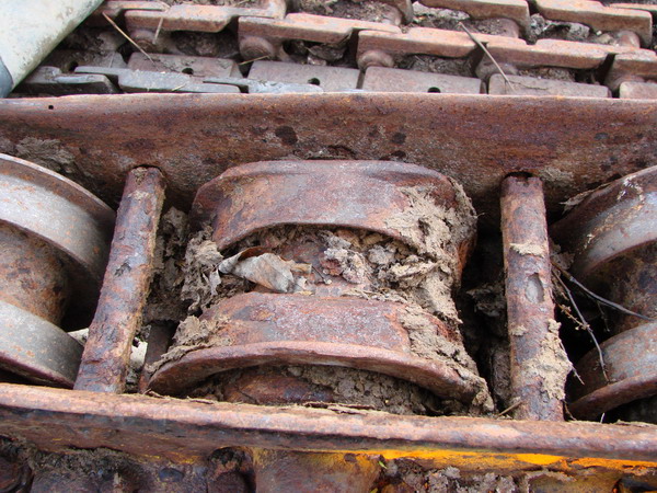

If your rollers look something like this, it is probably time to rebuild them.

Post by digitup2 » Tue Jul 15, 2008 6:27 am
That one roller is just along for the ride!!.I would say it has been siezed for a while .Digitup.
Post by NNAATZ » Tue Jul 15, 2008 6:45 am
more of a skidder than a crawler!

Post by Gil » Tue Jul 15, 2008 9:12 am
You mean they are supposed to turn? This is the other side. :roll:

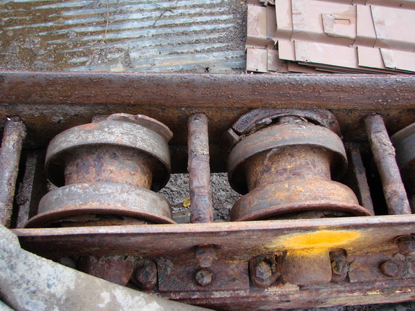

Gil

Post by Gil » Tue Jul 22, 2008 10:25 am
Luckily these pictures are from a parts crawler that I just bought. Years of pushing out manure from the barn took their toll. I did get a good engine, transmission, and direction reverser in the deal, AND no need to rebuild the undercarriage! :D

Post by Gil » Sun Aug 17, 2008 9:36 am
I eventually got around to removing the rock guards and the rollers from the track rails that are in the pictures above. I have had problems in the past with breaking bolts when I tried to do this.
The reason for this update is to tell you how impressed I have been with a half inch drive Ingersoll Rand 2135Ti impact air wrench that I bought to disassemble this crawler. It removed ALL of the roller and guard bolts without breaking a single one. I did not even need to heat them with the torch. My air compressor is just a standard 1 1/2 hp Sears 30 gallon air compressor. Every once in a while I had to let the compressor pressure catch up, but I am now a definite supporter of this rather expensive Ingersoll Rand impact air gun.
The 15/16" bolt heads on the track frame cross member were a little bit more of a problem. I had to heat the mounting block with a rosebud on my torch. But again the 2135Ti got the job done. On one bolt I reverted to using a socket and breaker bar, and the bolt head snapped right off.
