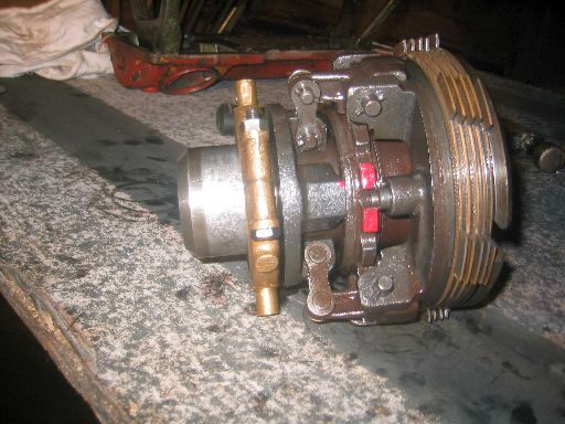

John, first welcome.
Second, please form sentences, with punctuation, you will receive more help if people can easily read your posts.
Third, I feel your pain, and just went through a reverser rebuild.
It sounds to me like you need to get that front clutch adjusted up properly, and then HOPE you don’t have to go through a full rebuild. Likely what has happened is the thrust washers have been badly worn out. Check the oil to see if you have copper bits in it.
As for adjusting the reverser, you need to learn how it works, and even though your rear clutch seems to be adjusted properly, it is much easier to see how that one works. So crawl under the machine, and on the left side of the reverser, remove the plug. You will find a dial type nut, with a spring pin. You need to depress that pin, and then turn the nut. I can do the rear one with my hand, but need a screwdriver for the front.
The manual outlines the procedure, so I won’t retype it here, but what I suspect is you have not rotated the front clutch to find the location of the pin. (remember you don’t have to do that for the rear clutch, it is already alighted with the inspection hole) Once you have rotated the clutch pack, and then released the main clutch, you will need to do the same as the rear clutch, and depress the small pin, and rotate the notched ring. I do this almost in one motion, by pressing the pin back, and then pushing the ring either up or down at the same time. You will hear the pin snap back into place when the next notch lines up.
Now since a pic is worth a thousand words:
Although you will not be able to see nearly as much of this, you are looking for the small pin between the red paint, which is on the ring. (yours will not will nave the paint) Push that pin right (rearward) and move the ring either up or down. You are probably going to need 2 notches to get it close to proper adjustment.
Get her adjusted up, and keep it full of oil!!
