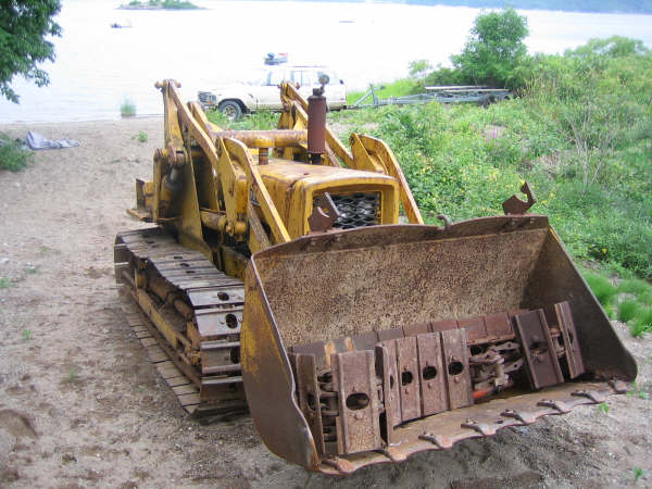

know where there is a set of 5 rollers how far from saint john nb canada are u in maine im 60 miles fr. calais

I'm in Lamoine (Right next door to Ellsworth). I'm not sure of the distance to St. John. Are they bare track frames or something more complete?

ill try to get some pic.think they are full tracks with rollers and idilers

ill try to email pic. can buy 20 cents a lb
