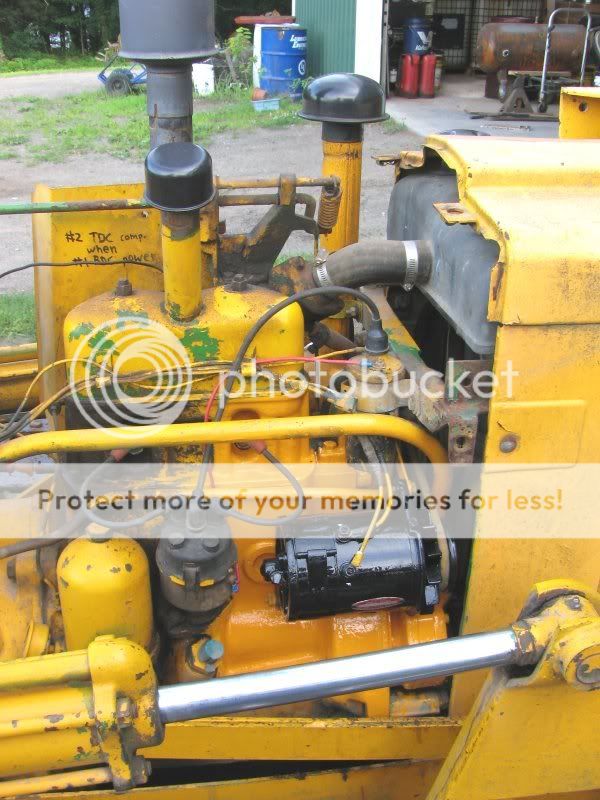

Post by Ray III » Sun Dec 28, 2008 5:38 am
This is what the distributor looks like on mine.
As long as the distributor can be rotated to line #1 up with the rotor it will fire. It just looks better this particular way.

Post by dhallstead » Mon Dec 29, 2008 1:16 am
Thank you for the pic when I put it on spark and put to rotor just about to touch #1 and points just staring to open that's where my distributor is at. So that's good. I'm waiting for the weather to warm up a little before trying it out. -20f right now. I'll wait until it hits zero before i try it. I did try it but didn't start around -5f. But i took the carburetor off and cleaned it seems ok. but I put it on and tried it and it was still pouring gas out the bottom of it. The spark plug were dry again. Why would it be pouring out the bottom??? And dry on the spark plugs???

OK I got it to run, but on the picture there I have the spark plug wires crossed. When I had it the other way (right way) it would back fire really loud. Scared me good. Blew off the cap to the exhaust and flew right by my head. I was lucky. With the wires crossed it runs OK. What did I do wrong???

Post by dhallstead » Tue Dec 30, 2008 9:58 pm
Hi here's what i did today. lol I took out the oil pump. Lavoy pointed out I did have it out 90 degree. Thank you Lavoy. So now it's like this.Image12-30-08_1655 The distributor cap has brass in it. that's all i know. I will look tomorrow. I will look in the PM snoopy thank you guys for all the help. :oops:

Post by dhallstead » Sun Jan 04, 2009 3:13 pm
update is -30F degrees below and not working on it. I got a new pulley, but still it just don't look right with the rotor pointing at the alternator when on TDC compression stroke. Good news is that it quick snowing and don't need it.
