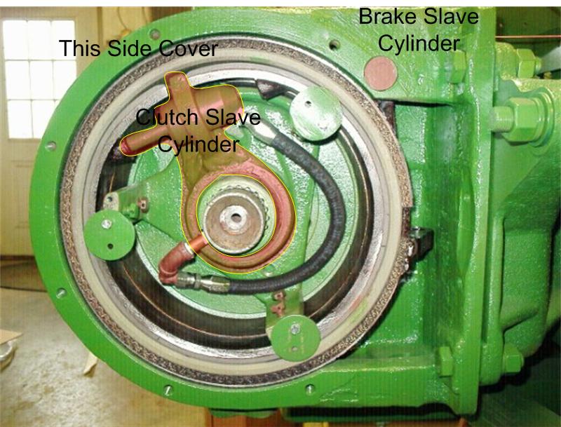

Here is what the inside looks like with most of the parts installed.

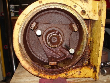

Post by lizrad999 » Tue Jan 13, 2009 11:28 pm
Lavoy,
Here is what mine looks like.

Post by Lavoy » Wed Jan 14, 2009 10:22 am
The biggest problem you will have is the clutch bands, everything else you are missing can be made, or I have it.

Post by lizrad999 » Thu Jan 15, 2009 11:40 pm
Lavoy, do you have the parts I've indicated on your photograph?
Do you know if anyone has ever tried to retrofit some 10" electric trailer brakes to the inside of this in place of the clutch band and hydraulics?

Post by Lavoy » Fri Jan 16, 2009 10:37 am
The clutch and slave cylinders I have, no side plates left.
Not sure how you would make an electric brake setup work, but doubt it would have enough pull to do anything.

Post by Lavoy » Fri Jan 16, 2009 11:09 am
The clutch bands are cast, and have a pocket in the one that the slave cylinder pushed against. It wouldn't really big a big problem to have them rolled out of steel, but I am not sure if they would spring back like the cast one do.

Post by Paul Buhler » Fri Jan 16, 2009 1:09 pm
Don't forget that the cover needs to have a recess that matches the big (~3") drum bearing, and you'll need the fitting that directs the brake fluid from the winch contol into the inner slave through the cover. Paul

Post by lizrad999 » Fri Jan 16, 2009 9:56 pm
This may all be a moot point if I can't get that clutch casting off of the splined shaft!
Right now I've got 10 tons pulling up on those two bolts in the picture while pushing down on the center main shaft, and she is even thinking about moving.
I've soaked it in Tri-flow, PB Blaster, and heated it up three separate times. Shouldn't that piece just slide off of the splines? Or am I missing something here.....
Lavoy, me thinks I might have to cut that thing off......have you got a spare one of them to? I know, I'm getting into the realm of "why bother", but I'm not ready to give up quite yet. :?

Post by Lavoy » Fri Jan 16, 2009 10:00 pm
On the hub, instead of using a puller, use bolts with longer threads, and use them to jack the hub off of the splines. Beg, borrow or steal an rosebud tip for an acetylene torch, and heat all the way around the hub as you tighten the bolts. Once it moves a little bit, then you can switch back to the puller.

Post by lizrad999 » Fri Jan 16, 2009 10:06 pm
I've got a rosebud tip (I knew I'd need one one day!), do I need to get the hub orange hot?

Post by Lavoy » Fri Jan 16, 2009 10:08 pm
No, you may not even have to get it glowing. Trick is to heat as much of the outside as you can so it expands uniformlyand lets go of the splines. You may have to get it a dull red, I don't like to get much past that, have distorted stuff in the past.

Post by lizrad999 » Sat Jan 17, 2009 9:19 pm
Once again, Lavoy was correct!
I kept pressure on the hub while I heated it with the rosebud, and before I knew it, it had slid off a little bit. I ended up spending the better part of the day getting the whole thing apart, but I still have all of my fingers and I didn't burn down my house.
