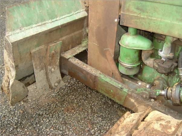

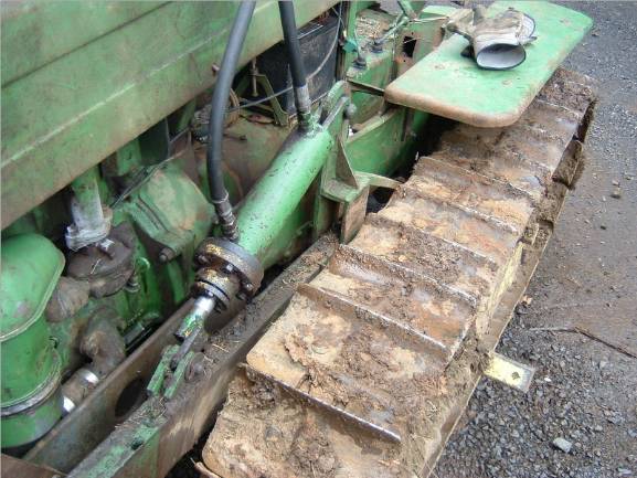

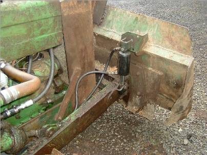

Post by snoopy » Thu Feb 12, 2009 2:37 pm
Image[/img]http://www.jdcrawlers.com/uploads/mc_balde_2.jpgImage
[/img]http://www.jdcrawlers.com/uploads/mc_blade1.jpgImagehttp://www.jdcrawlers.com/uploads/mc_blade3.jpgImage
The blade on my MC was home made, but not by me. It will tilt but will not angle. the tilt feature is nice for cleaning out ditches. Two rams. [/img]

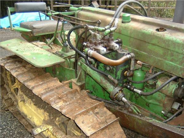

Post by snoopy » Thu Feb 12, 2009 4:03 pm
this should be three more pictures of my MC blade

That looks pretty well built, I wonder if it might not have been a jobber blade for the MC, or at least started life as a jobber blade for another brand of crawler.

I like that tilt cylinder. I have been contemplating if that would work or not, so now I know it will. I am going to cobble one out for my blade. There is already a double valve assy on the machine.

I purchased the machine from the John Deere dearer in Grangesville Idaho in 1979. The pump that was on it was a underpowered belt driven vane pump. Finially got around to replacing it with an orginial pump this winter just before the snow hit. the Push beams are just two pieces of u-channel welded together. Had to repair them in the 80's when I was pushing a lot of stumps out. It is a nice running machine.
