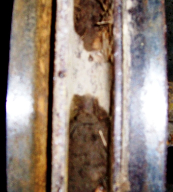

OK, remeasured all the alignment and while not exactly the same as the good side, it is VERY close. I split the track and removed the idler. I think I found the problem. The alignment must have been bad for along time and the idler is worn such that there is a large thickness ridge on the idler. With this ridge, the track does not want to run up onto the thicker part of the idler. Here is a picture.
The rusty looking area on the left side is a lot thicker than the shiny part. The track was that far misaligned. You can also see the the right side of the idler has been rubbing and is thinner.
So, I can try building this all back up with the welder or get another idler.
Suggestions!
Suggestions!
