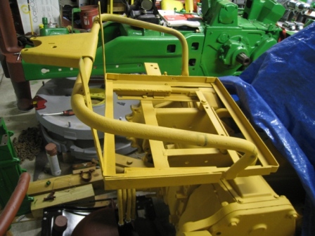

By the way here is the seat frame that is currently on the 420. Is it the correct frame??

Post by Lavoy » Tue Aug 18, 2009 8:03 pm
The basic seat is correct, just should not have the toplink bracket. Yes deluxe seat will work, done a few, but you will have to space it up slightly, and will not be able to slide it back all the way, or the toplink will hit it when you raise the 3PT all the way up.
I had a 420 with a stacked dual valve, worked fine, they just made a homemade lever, bracket and linkage. The bracket bolted directly to the front of the valve, the lever was fairly short, and did not have the capability for float, but it will work.
