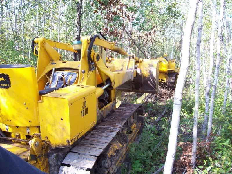

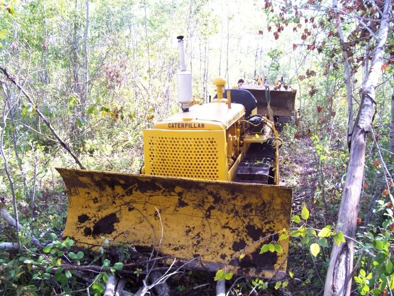

well after finally getting my 1010 dozer out of its mudpit hellhole it had been sitting in for 5 months Via the help of a liitle D2 I picked up.It took approx 10 minutes to get it out.I would have been quicker if the JD wasn't powering out.
I find that the 1010 barely has the power to turn the tracks to move it to a place to start draining fluids to work on it.It would struggle to go about 15' before dying out and would be hard to start unless I let it sit for about 15 minutes.
Would this be something to do withold fuel (5 months) the fuel filters or is there an inline filter along the way,or could it possibly be air restriction as maybe some little critter built a nest in the air filter?or maybe something else?

Hello, I would call that a quagmire. lol. I dont know the 1010 so im not gonna say much, but I would start with filters and then go injector pump maybe. That is one super nice looking set of crawlers. The dozer and a loader are a very nice pair. Im sure someone will chime in to help. Tom.
