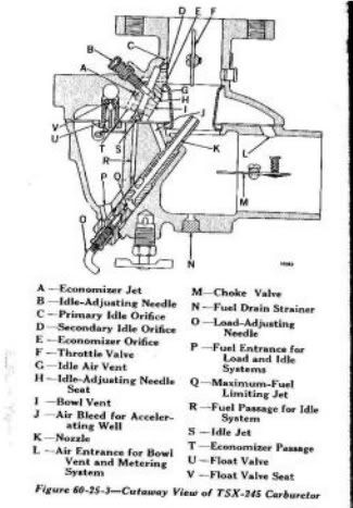

Lavoy: On my TSX688, I have to completely close the idle jet to get a smooth idle.Idle mixture screw on a Marvel Schebler TSX series is an air screw, not a fuel screw. All the way in is full rich, out is leaner.
Any ideas as to why?
I've disassembled the carb, cleaned all the ports and galleries with compressed air and carb cleaner, and then reassembled it with Permatex on the gaskets to seal up any gasket air leaks - I also checked and tightened up the throttle shaft felt seal. The tapered idle pin looks good - no evidence over tightening. Thanks

There are idle circuits that many times need to be cleaned with a wire. Compressied air will not always get the crud, even if they have been soaked.
What is happening is similar to having to use choke to keep one running. Instead, you are having to close the air bleed all the way to full rich just for it get enough spray to run at idle.

This is the basic design of the later TSX carbs. My other books are at the farm.
Believe it or not, sometimes they will clear up or run a little better after you put some hours on them.
As you can see by the diagram, there are a number of ways the idle can be fouled. P, Q, R, I, H, G, T, C, and D can each have some small crud, varnish, or rust particles in them and cause problems.
You never want to use anything but the drill bits that are specifically made for this carb, and use them with great care. These are small and precise passages. Any enlargement of any passage can create issues that can never be fixed correctly.
Also, the holes in the nozzle must be aligned properly, and the velocity stack must be in the correct direction.
This is part of the reason why so many carbs, after soaking and compressed air, etc., still do not function correctly.
