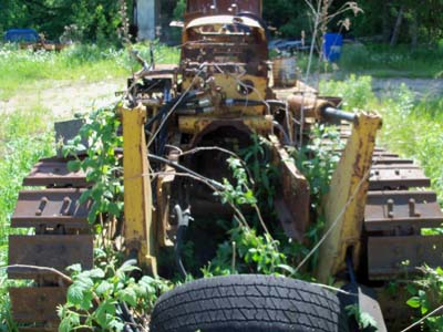

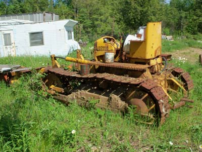

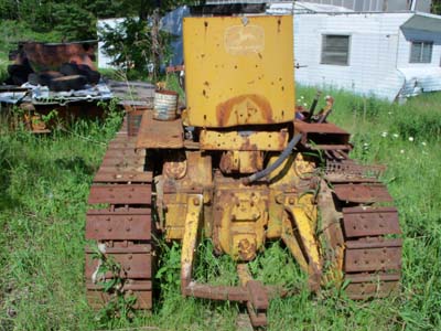

Howdy folks... I am considering buying a parts machine thats 280 miles away... but am stuck on what it might weigh. It's a 2010C, missing the diesel engine and a few other parts. I have read on here that most people say the machine is about 6.5ton, or 12,500lb. Would it be fair to say the engine is 1500lb and it would be around 11,000 total?
All I really need is the tracks from this machine, as I am going to cut out 4 links and put them on my 1010 4 roller, that has 32 links. I figure if I am driving that far, he is selling the machine at scrap value and I should take advantage of it. Are the 2010 sprockets the same as the 1010's also? Here are some picture of the machine. Any advice would be appreciated!

I would guess you are at 6-7000 lbs left. Only a loader is over 10,000 complete.
You will have to take out 7 links, 2010 is 39 links. Sprockets are completely different. I think I have a set of sprockets left if you still need them.

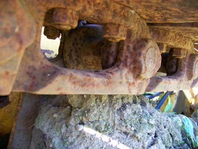

Post by Tigerhaze » Wed Sep 14, 2011 9:31 am
You probably should make sure that this is an early (pre-42,000) 2010 so the pin/bushing diameters are same size as a 1010- the late 2010s had pin/bushing diameters same as a 350. I would say they are the early tracks based on the photos but sometimes hard to tell without measuring or looking at part number on the sprocket.
The bushings look like they have a little wear, but the rail height looks good. Sprockets also look like in good shape.
