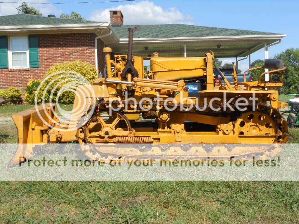

Ok guys thanks for the help. I tried draining the oil and filling it back up with PB Blaster. I made a handle to turn the crank and it will turn but not easily. I pulled the plugs and when I move the crank PB Blaster comes out of one plug hole but the other does not. It appears that that cylinder does not move at all. I have been waiting patiently for the Blaster to work more on that side for a few days. I know it is necessary to rebuild this thing for the long run but how much am I talking cost wise without any labor for the parts I would need? Thanks in advance! JD
[/img]ImageImage
Image[/img]

i would say you have NOT gotten a full turn on the crank yet ...if you get PB BLASTER pushed out on one cly. then you have moved that piston towards TDC you need to work the crank back and forth and hope that you will get a full turn some time in this lifetime ....if its that stuck and you finally get a full turn i dont think i would do much more than get it started and check out a few things.... if i did even that before i pulled the head and pan.... PS she looks to be in pretty good shape (tracks ECT.)
Post by NNAATZ » Thu May 30, 2013 5:29 pm
seein the u/c, thaat crawler is very much worth whatever you do to it
