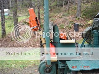

Here's a picture to link to my Photobucket site too. Click on it to see other pictures as well.
I like my FOPS for its simplicity, and light weight, but Tom and others have made nice ones as well. Thanks pop pop for the compliment.

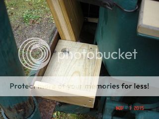

I recently replaced the 2x2x3/8" angle iron over my winch with 3x3x3/8 and turned it around so that my choker hooks won't catch when they reel in close to the drum. I also replaced the mounting bolts on the winch with grade 2 bolts so that they act as shear pins if I back into anything - I don't want to chance damage to the winch housing when that happens. This setup also allowed me to make some pressure treated platforms/boxes that tuck in behind the seat for my chainsaw bar oil and gas mix jugs to be carried conveniently out of harms way.
pictures of this new set up.

Ken: We used to use a 350 with a similar pipe boom. It had a small FOPS that bolted to the side arm structure. The limb risers only went from the boom structure to the fops roof. There were no other front posts so that the seat was easy to get in and out of. The cables were all in front of and/or above the cage. It was made out of 1-1/2" water pipe cut and welded with a 3/16" roof. It was designed to slow things down if they tried to enter the cab area. We all knew it was a cobbled affair, but the bent rear uprights and dented roof showed that it worked. Good luck with your fabrication. BTW, your machine looks just fine and I bet it serves you well. Paul
