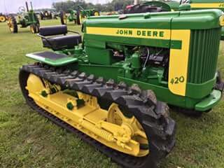

I'm intrigued. Just came across this. Any ideas what these tracks came off of?
Re: 420C Rubber Tracks?
Replacement tracks for BD2 Mitsubishi.

Lavoy-- do the rubber tracks fit on the stock sprocket and idler for the 420C
1957 420C four roll since 1982
No, sprocket has to be re-rimmed with the Mitsubishi rim, rockguards will likely have to be cut off shorter in height, and will only work on 5 roller crawler. Right now, in the $5000 range to do it, not including machining.

That price tag on rubber tracks wiped out my interest!
Yeah, tracks jumped by $1000 last year.
