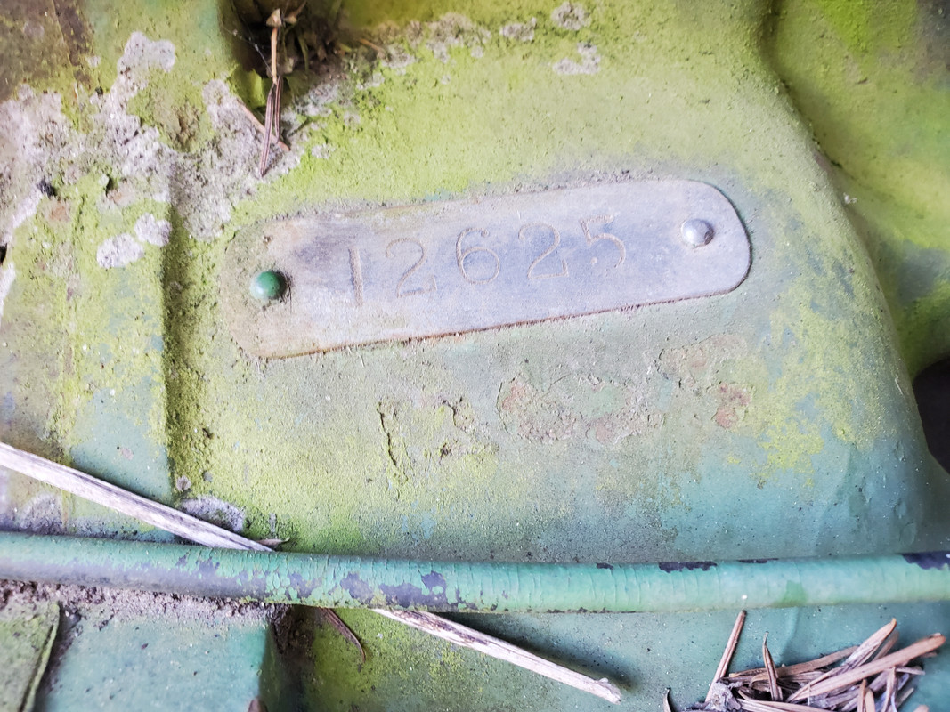

Based on the posts about serial numbers, mine should be between 80,001 - 136,868, but the tag reads 12625. Is that a valid number? If not, is there another way to identify it?

The tag in your picture is not a JD model/serial number tag. The tag should be on the left side of the bell/clutch housing, is larger, and has the model and serial number along with more info. If you search John Deere 420 specs (ag tractor not lawn tractor) Tractor Data has a picture of a 420 tag, the 420C tag looks the same (except the model will be 420C).

That is an inventory control tag like used at dealerships, municipalities and such to identify a piece of equipment. Look on the LH side of the center section between the sediment bowl, and the front of the transmission. If you have a tag, that is where it will be. You have an "all green" 1956 420, 80,001 and up serial number.

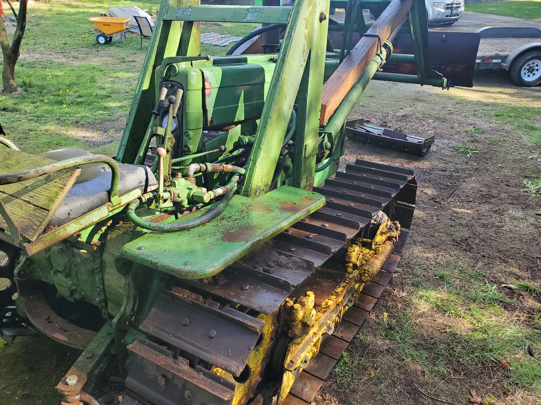

That is also known as a series one or early 420 crawler (1956).Interesting blade/loader on that crawler looks like a homemade set up ?.Welcome to the forum

How is the undercarriage on this crawler?

Well, I have no experience with crawler undercarriages. Based on what I've found on this forum and others, I'd say ok to good, but here are some pictures and maybe you can tell. The grease fitting on the left Idler is missing, hopefully it wasn't run long without it.
In the last picture, the other end of the tape measure is at the left side of the pin (almost exactly 23")
where do websites get their images
free jpg images
any other measurements that would be indicative of wear?
I suspect the loader/blade setup is partially homemade and partially cobbled together from other equipment.

Did you put a pin or pipe, wide enough to pick up both rails, in the sprocket and back up to stretch the chain tight? You need to do that to get the correct measurement. I would say those tracks are likely fine for your use, it is no longer a production machine.
