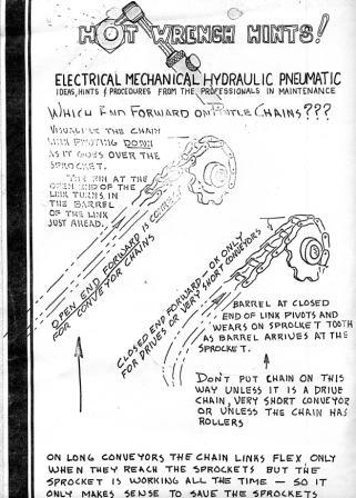

Corret direction of the chain
Hey guys,
No one mentioned the proper way to mount the chains on a sprocket.
I work in a sawmill; according to the maintenance department the open end of the chain should reach the sprocket first.
"The pin at the open end of the link turns in the barrel of the link just ahead." If mounted the other way: "barrel at the closed end of the link pivots and wears on the sprocket tooth as the barrel arrives at the sprocket." (I was going to post a picture of the newsletter, it had pictures and much more explanations, but my brain is fuzzy today and I couldn't get it done.)
Mounting a chain "backwards" on a crawler probably doesn't cause as much excess wear on the sprocket as it would in a sawmill conveyor since the crawler is going backwards part of the time and working in sand and mud. Sprockets are getting hard to come by though, and every little bit helps.
Brian
[/url]
Brian
[/url]
Hey,
My brain unfuzzed. Here is the document from maintenance.
You have to think upside down from the pictures in the newsletter.
B.
B.
