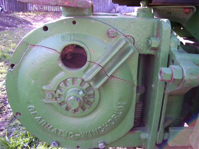

Does anyone have any good pictures of the inside of an operational winch or even better a manual or parts list. I'm going to try and restore the winch on the 420 crawler i got last month. I know i'll be making parts as some are completed pooched.

Okay another try with a pic.

dave, i am currently working on a gearmatic for a customer, i am just about done, but i still have the cover off, i will take a pic of it for u tomorrow. i also have a couple of them all torn apart, i can take a pic of them too if u want.

Post by Davie Sprocket » Wed Sep 26, 2007 12:01 pm
Cool that would be great, this one still turns with the pto but other then that i think i will have to tear it apart before i know how bad its gonna be.

Post by JD430C » Wed Sep 26, 2007 9:20 pm
here is what i took today.

The rights to Gearmatic are owned by Paccar. If you go to Paccarwinch.com and contact them, they will sell you a manual. Don't remember how much it was, but not expensive. Unfortunately they have almost no parts available any more. I have some new and repro parts available, let me know.

Sent paccar an email and they haven't got back to me, seems alot of people are looking for the manual for the 8a, google had pages of guys trying to find them in one forum or another. I need to pull the winch apart and see whats missing, i'm working on casting a new cover, be aluminum but hopefully it should work. If not i may be able to stitch and lock the broken one back together but thats gonna be a lot of work.

Casting a new cover will be kind of pricey I would think. I probably have a used one on a parts winch, would have to do some digging.

I could duplicate that cover in cast iron as I work in a grey iron foundry, but seeing as you are in Canada, the shipping would probably be too much trouble.
Try to find an iron foundry around you that still hand molds parts, if you have the part that they can use as a loose pattern it is not much work to reproduce it.

Worst part of up here is the price of gas jumped about 5 years ago and killed all the foundries the only ones left are doing aluminum. All the steel work i know of is out of china. I'll have to work on it in the winter, tried to get some parts off it and they are rusted solid, probly how they broke the cover. Thank for the offer though Ray, if i could i would, damn border piss's me off all the time.
