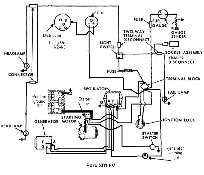

How do I get a positive ground?
I have a wire from the switch to the positive side of the coil ,then the negative side of the coil goes to the points as this is how it was wired when I purchased it this year. So that is how I put it back when replacing the points ect. So is this hooked up wrong?
I do have 12 volts from positive side of coil & 12 volts to points when open.
My manual does not show how to hook up the coil wires :(

12v systems are negative ground. 6v systems are positive ground. All along, I have been talking about a 6v positive ground machine. This includes the way the starters are engaged via a pull rod to a manual switch.
The polarity of the ground is which battery terminal is hooked to the machine itself.
Most coils in 12v machines are actually 6v coils. They have a ballast resistor between the power feed, as in ignition switch, and the coil input. This drops the voltage at the coil from 12v to 6v. If this is not present there is a very good chance of burning out the coil primary winding.
The 'hot start' mentioned is where one runs a wire from the start terminal of the key ignition switch to the coil input. So, 12v hits the coil when the starter is engaged. And only while it is engaged. This actually puts about 9 volts onto the coil since the starter load pulls the battery voltage down. That produces a hotter spark than normal, which helps starting. The 9v is not applied long enough to damage the coil. Once the key is released, the coil is fed via the run terminal of the key switch and the resistor is back dropping the 12v to 6v for the coil.

Will someone please explain in simple terms what is a "positive ground"
And how to properly hook up the coil, as I think the previous owner had it wired opposite as shown in the manual. It ran that way for the 8 months I have owned it. BUT now no spark.
1964 JD 2010 w/820 loader

Attach the positive post on your battery to the frame of the machine.
JD 350B diesel 6way blade, Case 580B Loader/backhoe, Farmall 504 high crop w/ flail boom mower, International 404 , International 284 diesel w/belly mower, 1972 Ford F600 dump truck, Galion 3-5 roller, Allis Chalmers D17, 1620 Ford
Posts: 994
Post by Paul Buhler » Mon Dec 14, 2015 6:05 pm
Edited: in a positive ground system, the positive side of the battery is attached to the frame, and the negative side to your starter. The current goes through its usual circle opposite that of a negative ground. The system will have a generator, not an alternator.
