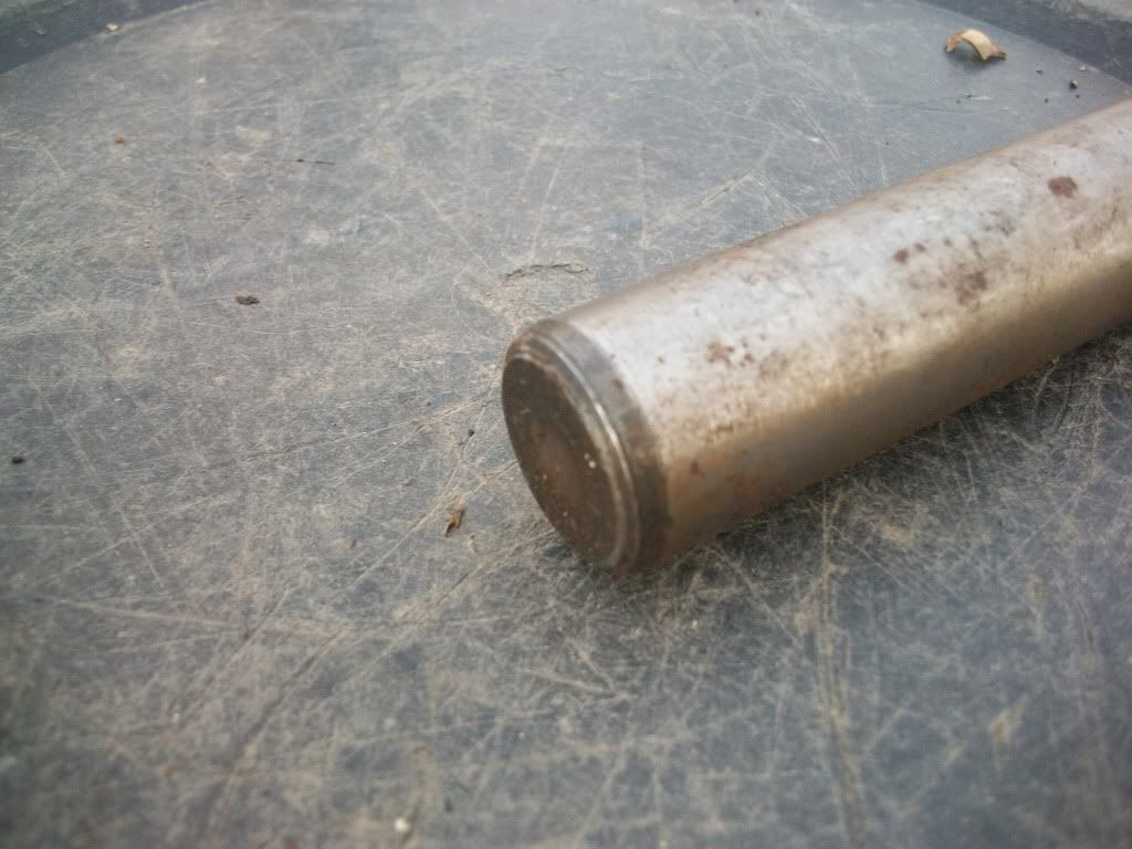

Here are the photos I took of the pin and bushing- as you can see there is a small bevel on the end of the pin and the inner lip of the bushing but it appears to me to maybe be more from the manufacturing process than an actual functional requirement-someone else would have to confirm that.Tigerhaze wrote:Paul-
I will get you photos over the weekend.
- Paul Buhler
- Posts: 994
- Location: Killington, VT
pin and bushing pictures
Thank you for taking the time to do this. A picture is worth a thousand words. I think that you are right. Some other people have PMed me with helpful info and support too. So the project moves forward. Paul
