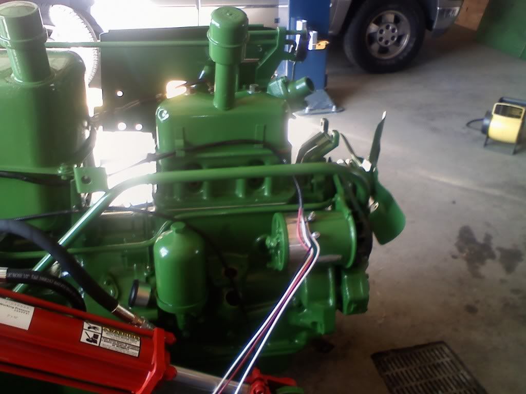

Thanks everyone. The head was damaged in one exhaust port from water coming in through the rotted muffler. It probably could have had a new seat put in but by the time I had all the machine work done on it, it would have been more $$$ than a new one.
I put the engine in yesterday. :D
Have a bunch of pics to upload of the rebuild and install. Hope to get that done later today.

Post by Top Gun » Mon May 31, 2010 6:47 pm
Block back from machine shop. Bored .045 over, crank turned .010 on rods & mains. I had it assembled it about 2 hours.

Post by Top Gun » Mon May 31, 2010 6:51 pm
I painted the short block and then put the new water pump on and hydraulic pump.

Post by Top Gun » Mon May 31, 2010 6:54 pm
I installed the short block and then put the head on. Heat shield, fan, etc.

Post by Top Gun » Mon May 31, 2010 7:00 pm
Radiator & front nose mount installed. (not recommended to do by yourself but can be done by balancing on your legs while trying to start a bolt on each side. Also make sure air wrench is in "tighten" before thinking your homefree) :x

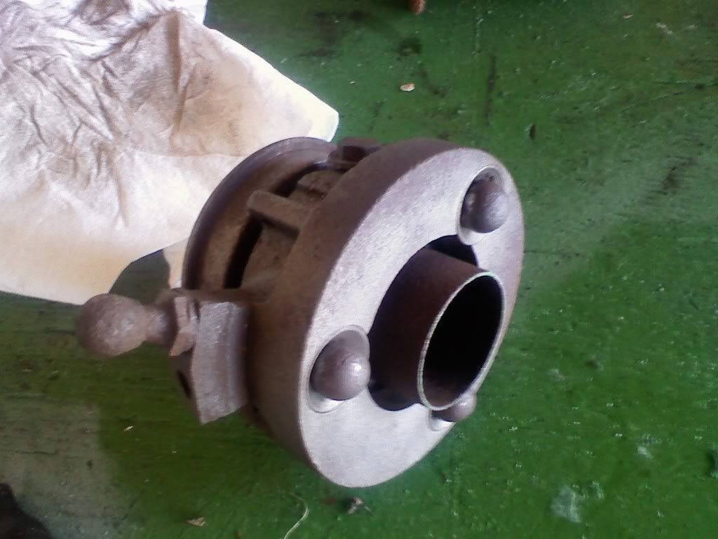

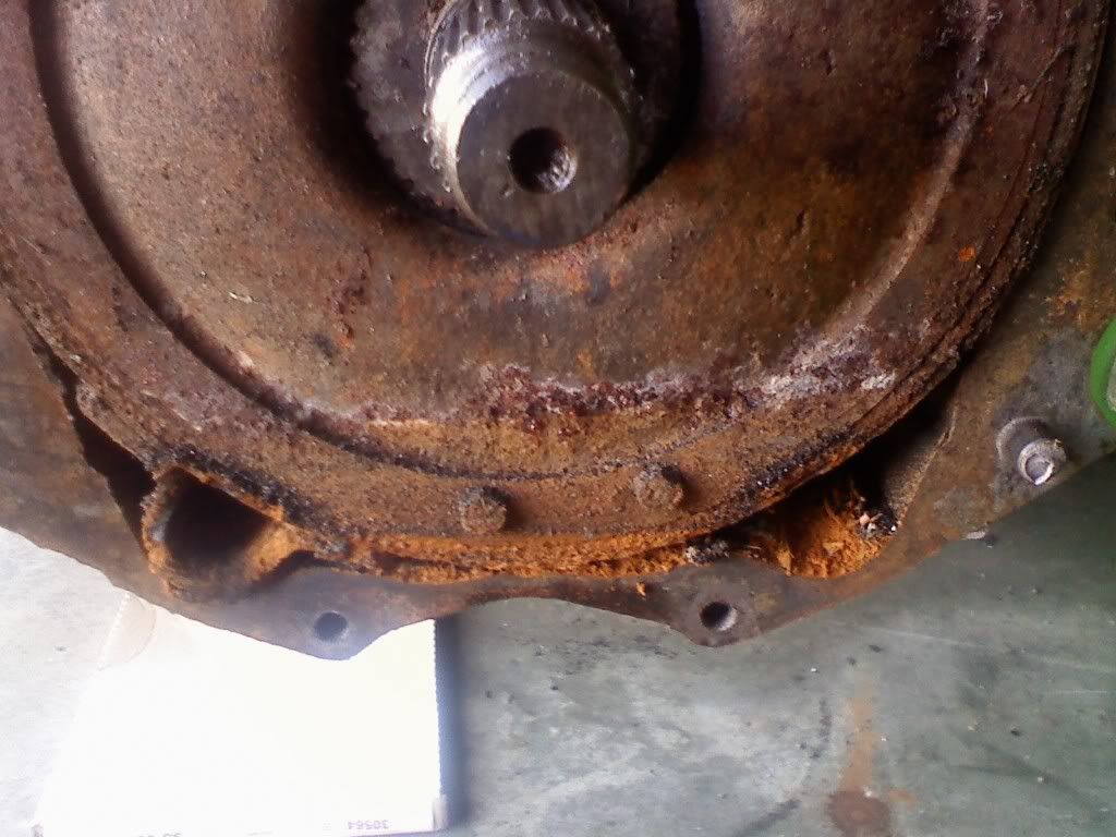

Post by Top Gun » Mon Jun 07, 2010 8:11 pm
New block heater.
When I took off the right side final drive housing I found it had about 2" of water in it over the years.
Left side release bearing holder bead blasted. Only had 25 years of rust on it from being left on the ground next to it.
The tube is wore out. I'll replace both of them.
This upper shaft was solid rust also. It cleaned up pretty well.
