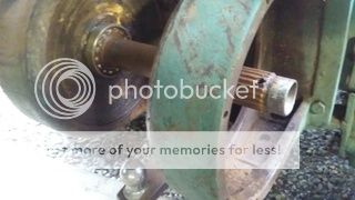

I'm finally ready to dig further into my winch. I am having an issue with the winch winding in on its own when under load, causing me to think that my inner bearing(s) are failing. I have the spider off, brake band and clutch off, and am looking at the side of bearing number 30 on the schematic (supposedly # 6211rsnr when replaced) I can pry the clutch/brake drum up and down easily indicating a worn out bearing(s).
From what I've read and from various comments, I need to remove the drum which can be a challenge.
It looks like the winch drum sits on two bearings (#30), and can be driven off towards the clutch side without opening the crown gear and pinion side of the winch. Am I correct in this interpretation?
Will the drum slide off the crown gear side bearing, or will the drum and bearing usually move as a unit?

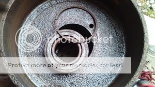

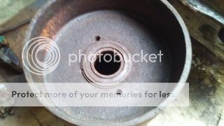

Well, It took more time to compose my last post than to disassemble the winch drum. Once the cable was off the drum, I started tapping on the drum with a ballpeen hammer to loosen things up, and the next thing I know, the drum was sliding off the inner bearing and off the main shaft. Spooky, way too easy - hope this isn't jinxing the project.
Once off, I was able to use a drift from the inside, and get the bearing out of the drum. It's toast, full of mud and sludge.

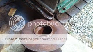

Parts ready for cleaning and re-assembly I'll be using some epoxy on the spider's splines when I re-assemble to take up some slop. Notmeu sent me a sample of what he used when he did his winch - thanks Tom. BTW, found our emails from when you rebuilt your winch. It's handy having part numbers, approximate prices and your thoughts.
Still would like to hear some of your thoughts as I wait for a new bearing - the inner one is still good, although not sealed. May buy a replacement for this one too while it's easy to get to now. depends on how pricey these are.

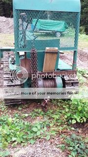

Hi: Finally got my winch back together. Rebuilt the controller. It needed a new o-ring and brake cup - 1-1/8" available at Napa. I honed the bores with a brake cylinder hone and used brake fluid as a lubricant. I used self- made paper gaskets glued one side with Permatex gasket shellac, and soaked them with oil before assembling. I was surprised to find that the last person had switched the brake side for the clutch side. I also replaced the handle shaft o-ring too.

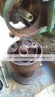

I replaced the clutch fluid lines with new stainless steel and brass fittings, using Permatex thread sealant.
I tried the hacksaw spacer method to adjust the clutch, but found that my clutch is eccentric, as compared to concentric, meaning that it wants to drag causing the drum to engage and reel-in when it's not supposed to. I wound up using various feeler gauges to get a go-no-go fit that allowed the clutch to "free-wheel" until engaged, but still has a close enough gap to engage and winch in as it should. This was a fiddley process requiring a few cover installs and removals as I dialed in the correct gap. Still not quite there, but at least the winch doesn't spool in when the clutch is disengaged as it did randomly in the past ( this was of major concern- I like my hands and fingers).
The winch clutch now has sufficient gap to free-wheel, and yet is close enough to have considerable "winch in" pull. The brake holds well and releases for a reasonably easy "free spool".
I'll probably take the cover off one last time and decrease the clutch gap a bit so that there is a bit more winch-in pull. I'm currently at a go, no-go gap of about .025. I'm hoping that a gap of .020 works better and still allows the clutch enough play to be safe.
