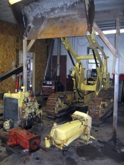

It is currently together, but this is what it looked like the last time the reverser came out:
-Neil
