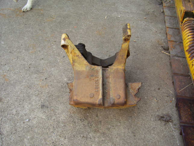

I finally got a 420c after several years of going to auctions. Best i can tell is its a 57 serial#102941 as best i can read, the serial plate is not in the best shape. At some point had a collision on the front and the radiator and shell are damaged, the water pump is gone, they welded a bearing so that the fan would still work. She's stuck so i need to try and get the pistons free. other then the motor parts i'm hoping the rest is in okay shape. I would like to get her running this summer.
I'm also looking for a dozer blade and a winch. I have no idea were to look for these so i thought i would ask on here. The main casting under the radiator is damaged as well and i would like to obtain one in good shape.

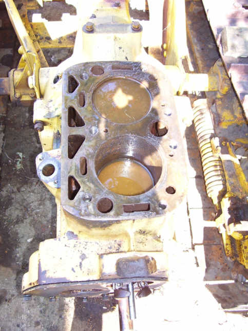

I'm gonna have to rebuild the engine in my 420c.
IS there a bolt or stud kit available for rebuilding the 2 cylinder motor. I have built some car engines using the arp bolt sets and its a great addition to a rebuild.
Or does anyone know what bolt cross reference to order them separately.

No bolts are available unless you find something that is a direct copy from the automotive world. Normally they are good enough shape to use again. I can't say that I have ever had to replace one.
Measure your block bore, I don't see a tach drive boss on the block, someone may have substituted a 40 engine for the original.
