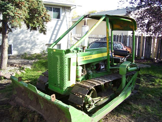

Heres a pic of the crawler and rops as it sits.
Also if the rops is not rated is it better to just have something or does that lead to false security?

jdemaris
Post by jdemaris » Mon Mar 31, 2008 6:14 pm
Davie Sprocket wrote:Heres a pic of the crawler and rops as it sits.
Dave
Anything overhead is good for something, e.g. keeping rain off your head, keeping tree limbs from crushing your skull, etc. And the crawler in your photo also has the added benefit of limb-risers, to guide tree branches up over your head as you drive under low cover.
ROPS is an old acronym for something like "roll over protection structure" - so if it's not strong enough to protect you from a roll over, I guess it's not a ROPS.
