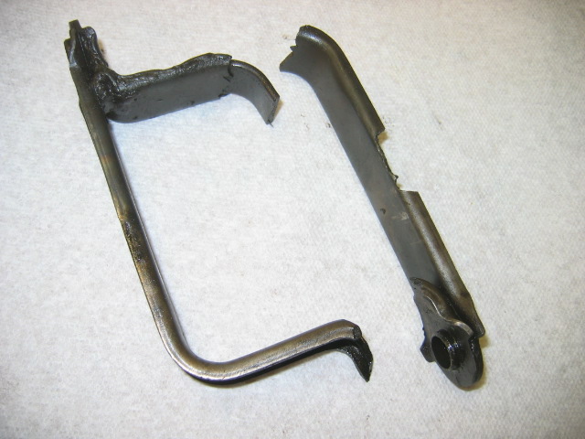

Post by Howsomever » Mon Jun 23, 2008 12:13 pm
After removing the engine the problem was obivious. The throw-out mechanism was broken. A PO had welded on it in the past. I am not impressed with the part so I plan to start from scratch. If I figured out posting pics there should be one below of the broken part. About two hours to remove the engine. I ended up removing the lower nose pieces and radiator before pulling the engine.

Post by snoopy » Mon Jun 23, 2008 8:46 pm
That is the same part that broke on mine. I live north of banks off of sellers road. i never removed the radiator when i did mine.
