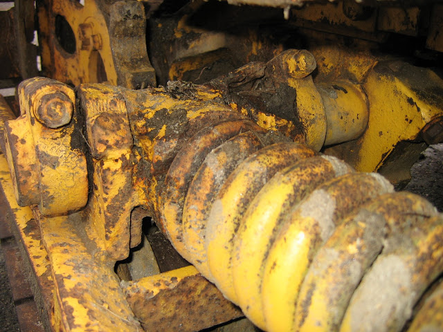

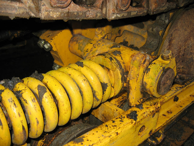

Here's a good rear trackframe mount. This is what it all should look like. You can see the round crossmember passing through the saddle with new capscrews in it. The capscrews thread into the other half of the saddle which is the front of the final drive case. You can also see the trackframe mounting casting is welded to the trackframe rails.
Here's my broken casting, a bad rear trackframe mount. This shows the split clamps on either side and messy attempts to weld the casting on the left side. The right side is gone, completely broken out. You can also see how this casting is welded to the trackframe, which is bent right below the round crossmember end (and clamp) on the left.
