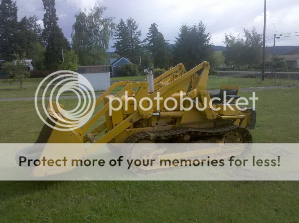

Here is a picture of Yakky.

Post by JD440ICD2006 » Sat May 29, 2010 6:08 am
WOW, can you get me a free one like that? :lol:
Looks really nice. That is the model 91 loader. A few adjustments and you will enjoy that machine.

The loader is an 831. Someone had put 1010 or 350 rails and disc front idlers on it, pads look good, again, you did well.

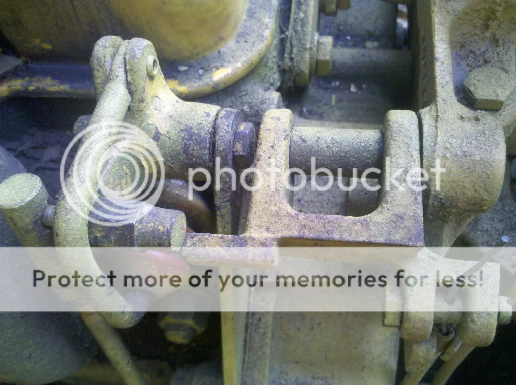

On a side note, I moved part of the throttle linkage around today, because the piece on the right in the picture is on a cable, like a machanical choke, but when you move the lever the cable moved the piece up and down but it was free from the throttle linkage. I put it as the picture shows because that's how it makes sence in my head. DOES IT LOOK CORRECT?
The KRAKR
Post by JD440ICD2006 » Sun May 30, 2010 5:02 am
It is not a choke but a fuel shut off. The only way to shut down a diesel is to either stop the fuel (or shut off the the air) since there is no spark like a gas engine.
I cannot tell from the picture if it is connected preperly. Your service manual will explain it.
