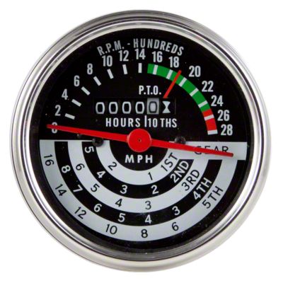

will the tachometer from a 1010 tractor work on a 1010 crawler?
Post by jtrichard » Fri Apr 26, 2013 10:45 pm
if the diameter and the mounting method is the same yes and no the tach will work BUT the speed part will be wrong i have a rubber tire tach on my 2010 i don't give a rats --- about the speed

Doesn't it run off the distributor ? I'm more concerned about hour meter
Post by jtrichard » Sat Apr 27, 2013 10:31 am
it drives off of the cam shaft same as dist. does ....yes the hour meter part of the tach will work http://s7d2.scene7.com/is/image/Steiner ... DS1499?$lg$ as said above the speed portion will be wrong for a crawler tach and hour meter will be accurate
