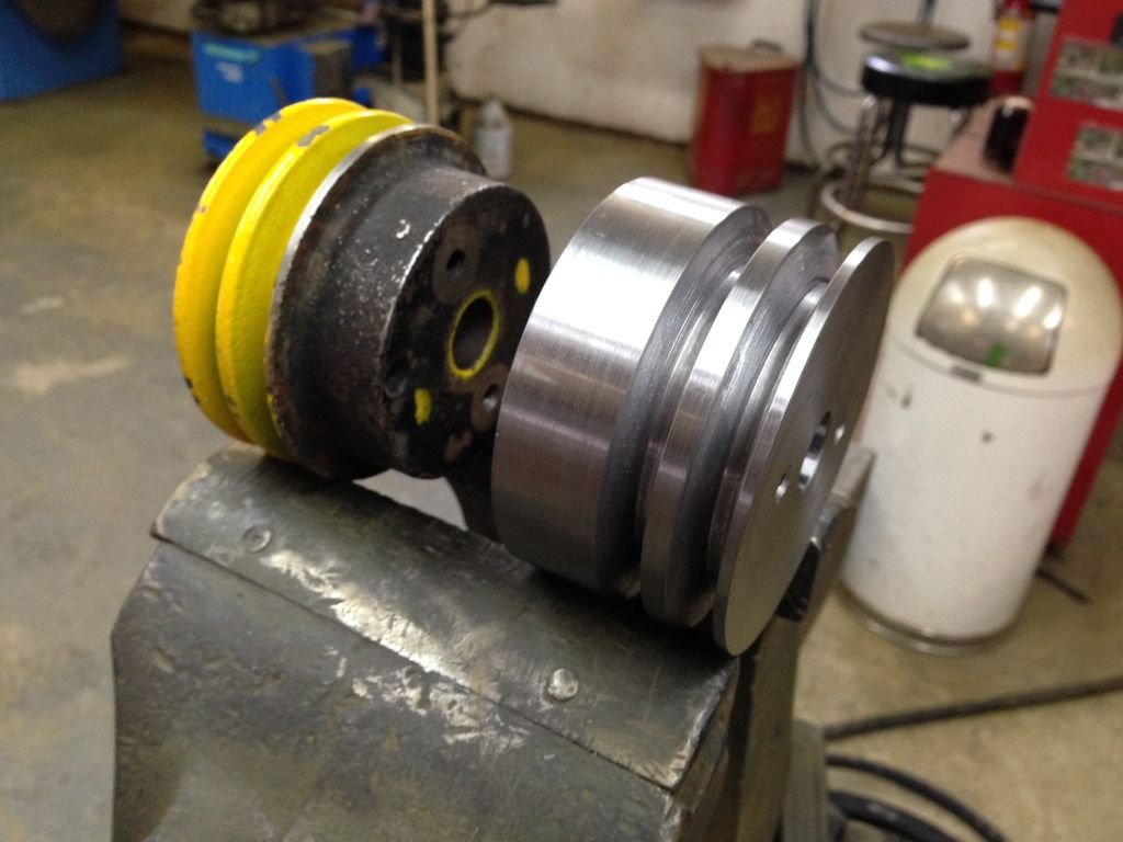

putting a upgraded one on plus its one wire and clean and i dont have the factory on. My water pump pulley is different ill get some pics

got a pulley made
Image[/img]
