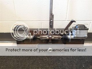

They are hyd control, basically a dual opposing master cylinder setup, hard to find unfortunately.

Here's a link to my Photobucket account (Click on the picture) where there are other pictures of this controller that another member shared with me a few years ago. I'm sorry I don't remember who this was, but hopefully he can chime in and answer any questions that arise. I'm not a Photobucket wizard, so you'll get access to more pictures than you may want. I'll figure this out better later.

I fabricated controls for an 8A winch but lost the pictures when I got my new computer. It's really quite easy to build the controller. 2 single reservoir master cylinders, 2 turn buckles, and some scrap steel I had, was all I needed. I spent around $100.00 for the cylinders, turn buckles,and some brake line. There is a place in Vermont, I believe, that might have the original controller or maybe some parts. I think Paul Buhler gave me the phone # but I lost that also. gregjo1948

I believe Lavoy has access to some of the original controller repair parts. I haven't found a consistent source that has used controls; as Lavoy said, they are hard to find. If someone finds one, it's worth picking up.
