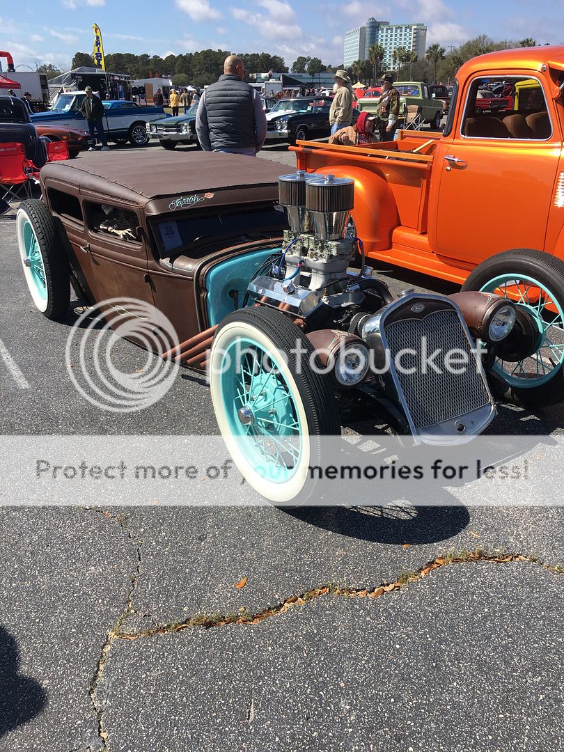

Thanks for your info Andrew, much appreciated! Here is what I am looking to build. The only items really needed from the A is the body, Everything else is from semi modern vehicles and a lot of custom fabrication, which is right up my alley!
