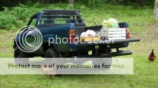

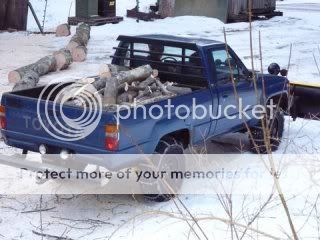

I've been happy with my 1984 Toy. I bought it in 1990 and put a Fisher plow system on it from a dying 1980 Toyota truck (frame and body rot). My family teases me about my motorized wheel barrow, but I like having a warm, reliable plow truck that has working brakes, lights, radio and windshield wipers. I'm disappointed, Toy websites talk about 220+ k engines, but mine had hiccups earlier. But like our dozers of choice, I was able to fix it reasonable easily and inexpensively ($580 start to finish).
As usual, fun to chat. BTW, I like some teas, but usually drink coffee - strong.
Rice burner - bah - humbug.
