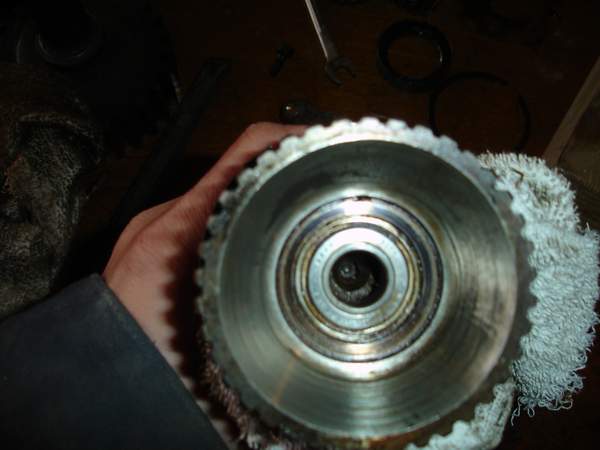

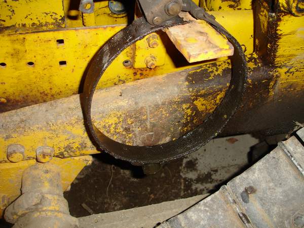

I got my finals off and apart today. I found that the inner seal was gone and it leaked gear lube into the clutches and brake band. The brake band was down to the rivets. Is there anyone who sells these redone?
Does anyone have any ideas how to get that pilot bearing out?
The inside of the clutch drum was full of gear lube from that seal being bad.

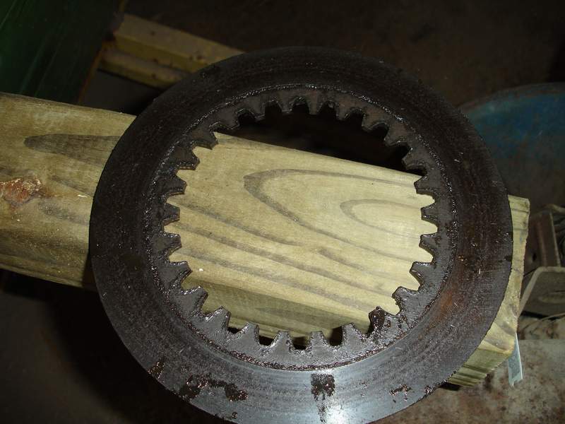

These fiber clutches were coated with gear lube. Other than that they look pretty good. Do you guys think I should use them or buy new?
Does anyone know what the thickness of the steel plates should be? What about the pressure plate? I am considering buying new also. Other than the bearings and seals being gone everything else looked ok. The bull gear in the final had some wear on a couple teeth from the bearings being gone but it still looks usable. I don't plan on running a business with it anyhow. Any input would be great. :lol:

Sand blast steel disc this will draw most oil out of disk --i have sand blasted fiber disc and had them work --dry sand blast will draw oil out of disc--- if this is not for commerical use this will save you a bunch of money and get you back to your project as for brake band this must be replaced and i'm sure Lavoy has them in stock (I have covered them with Comet household cleaner and let them set for a few days this will also dry the oil) have fun Randy

My personal opinion is it is not possible to remove oil from fiber discs. I cleaned a set once that was spotless and dry. Put the crawler together and two hours later, the clutch gave up. I pulled it apart while the clutch was still hot, and the oil was weeping out of the discs as they got hot. That was the last time I ever reused a fiber disc, I don't like pulling finals that much, and discs are not that expensive, especially if you are going own the crawler for a while. Fix it right, and you are likely done for your lifetime, unless you are using it commercially.

I agree with Lavoy not to put the oil soaked fiber disc's back in. If you do within a year you will be pulling the final drive off to do it right.
To pull the pilot bearing they (Snap-On, OTC, etc) make a slide hammer with adjustable jaws that will make it easy to remove.
Lavoy should have all the parts you will need (also replace your pressure plate). Also make sure to get the clutch finger height setting gauge and to have a set of 440 JD manuals (service & parts). If you search the posts on this site someone offers the manuals on a cd and also you will find the thicknesses for the disc.

I'll add to the advice to *never* reuse oil soaked fiber discs.
I've experienced the same as Lavoy - they grow hot in use and the heat pumps the oil out to the surfaces.
I learned this twice, actually. I figured after the first 'weep out' that was the end of it, re-cleaned them and re-instelled them. Only to have it occur again.
That's when I found out that brand-new fiber discs from the Deere dealer were very cheap indeed! :P

If you don't have a slide hammer or pilot bearing puller, get a bolt or dowel, or piece of shaft that is the same diameter as the hole. Fill the cavity behind the bearing completely with grease. Put the bolt or whatever in the hole, and hit it with a hammer. You will need to refill the cavity a couple of times, but eventually you will blow the bearing out of the hole.
If the seal or shield pops off the outside of the bearing, then you are out of luck doing it that way, just as well get a torch.

Do you agree with Sand blasting the metal Disks? I have mine apart now and they mostly rusty not real deep, and was thinking of havening them re-faced? and check the tolerance as stated in the SM, but thought it best to buy new ones and not mess with it.
ouch$$$ since I have both sides apart, "Just do it" and re-bearing, Seal, Disk, Plate, Bushings etc. while I have it off now and make everything like new. and maybe next year, start on the under carriage, My rollers look shoot, any suggesting there as well, I have a parts machine with rollers but haven't gotten to look at their condition yet.

If the discs are perfectly sound, and all you are doing is cleaning surface rust off, it should be fine. If they are pitted deeply or really rusty, then I would not do it, steel discs are not that expensive.
