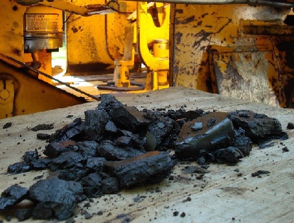

This is an old photo from when I just got the thing and was carrying out a complete inspection/maintenence of everything. I thought it would be fun to share!
As you can see it looks like the oil soaked earth being mined up in Canada!
The most frustrating part was trying to roll the wire mesh filter just-so that it would fit. The vertical position of the filter housing nestled inside everything doesn't help. I wish it had the replaceable paper element like other JDs.
JD 2010 Crawler Loader 7,500+hrs. and still ticking

did they use the air filter for plowing? the blade must look new! ha,ha . it must have run alot better when you cleaned it up, my filter was dented beyond repair im going to try a k&n fiter that the kids put on there cars, they look like a cone with a hose attached, i guess it will be better than none..thanks for sharing picture..Eric
