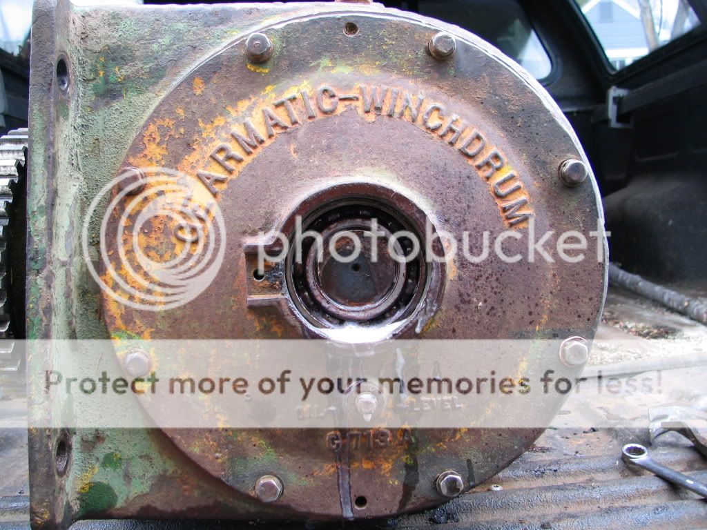

After alittle cleaning up. Yep, she's been used and abused

In the process of removing the cap screw and bearing screw cap
440 IC #448161 W/Henry loader, 3020 D, #8 mower

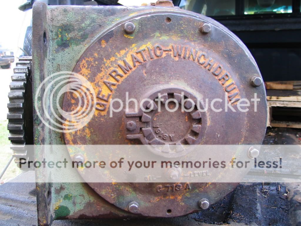

by Digger SR » Sat Nov 20, 2010 3:04 pm
[/img]
Sucess..with the bearing screw cap

by Digger SR » Sat Nov 20, 2010 3:19 pm
Side cover came off pretty good considering how long its been sitting outsied in the elements. Patients and penatrating oil with some selective tapping with a hammer[/img]

by Digger SR » Sat Nov 20, 2010 3:23 pm
Now the other side. All the cover bolts were snapped off except 1. The 2 you see are the jacking holes after they were cleaned out with a 3/8ths tap. [/img]

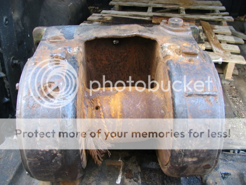

by Digger SR » Sun Nov 21, 2010 4:42 pm
Attempting to remove the Brake side Cover after soaking in pentatrating spray for a day and some light taping in selective areas with a hammer[/img]

by Digger SR » Sun Nov 21, 2010 4:44 pm
uck...now what?[/img]

by Digger SR » Sun Nov 28, 2010 10:17 am
Any ideas on how that tube rod come apart off the break band? manual was very vague on it shall we say? 2nd to the last picture for those following along on the right had side

by Lavoy » Sun Nov 28, 2010 11:53 am
The part above the tab on the band is like a push rod with the bottom end cut off. The bottom part goes up inside of it. They are probably rusted together, heat and vibration work the best.

by Paul Buhler » Mon Nov 29, 2010 10:30 pm
Hi: It looks like you're making progress. Congrats on getting the side covers off intact. To get the brake band off, remove the actuator located on top of the winch - it connects to the remote control lever that mounts on the fender, and you'll have access to the top of the rod that Lavoy mentioned. I soaked the actuator in brake fluid to get it working on mine.
Remove the three brake band retainers (Round plates with two screws each) looks like this may be a challenge - on mine I had to grind one broken screw off and drill and re-tap; not much meat to work with. There is a drift dowel that holds the brake band while it expands and contracts that is exposed near the winch drum and drives out from the cable side towards the cover side - you can see it in your ugh picture. Once you get these parts loosened or apart, the brake band should move more freely around the drum. There are paired alignment screws held with wires that center the bands over the clutch drum that you can't see yet. Good luck getting things cleaned up and free. Paul

by Digger SR » Tue Nov 30, 2010 9:09 pm
I kept working on them Lavoy and they finally came loose. Thanks
I got the actuator off today and... that pin gave in on me today. Thanks Paul. Didn't know it had to come out from the spool side. Anybody hear of this Gibbs penatrating oil before?...... so far so good. Them brake retainer discs are another story. All of them would not budge. So i just ground them off with the right angle grinder and will have to try and retap them later after i get the spider out, and then i can work on the those alignment screws alittle easier
