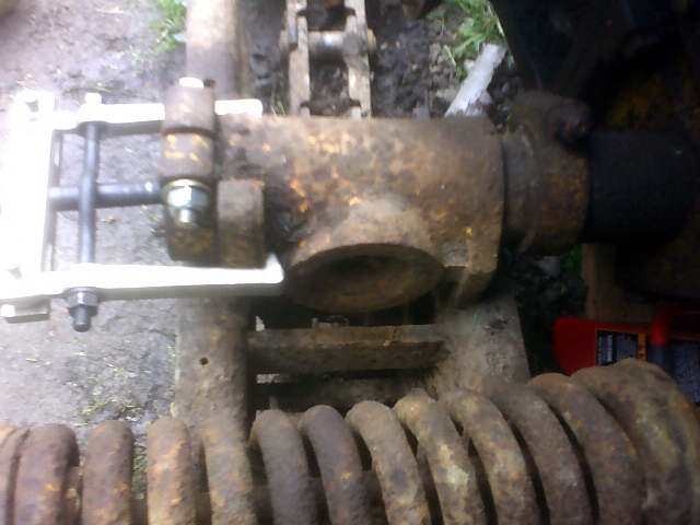

the first job was splitting the chain. after all the horror stories this one was pretty simple since someone used a one inch bolt for the master pin. A little help from my good friend Mr. Victor 100 and...
seems i'm in luck. all five bottom rollers are in great shape, ditto the upper idler. the front idler... well, uh, looks like i'll be making some more bushings and maybe turning a shaft down.

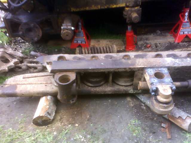

the next job was to pull the track frame. seems that of the eight bolts holding the front crossmember to the track frames only three remain, the other five having been broken off long ago. those three remaining bolts are all on the left side by the way...
that outer clamp is actually loose in case you're wondering

How tough was it to remove that right frame? Did you have to heat the front crossbar mount at all? I've seen some pretty intense rigs for removing the rear crossbar but you did it with a puller. Had the frame been off that you know of before you got the machine? My front crossbar had broken bolts also. I hope mine comes off like yours. Good luck with the rest of the project.

The original title of this post was "440 icd falling apart". Thats how easy it was. The most difficult part was removing the master "pin". As mentioned above it was a one inch bolt with a one inch nut that had been cross drilled and locked with a five-sixteenths bolt and nut. Used a rosebud to heat each part up to orange-yellow. A sixteen pound sledge did the final "pin" extraction.
The track frame hasn't been off for awhile judging by how badly the clamp bolts had eroded. Both cross member sockets were full of northwest clay which this time of year is as hard as warm butter. Heat would have turned that clay into stone.

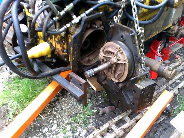

The money shot...

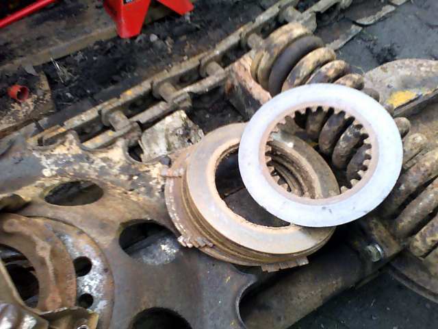

Whats wrong with this picture? Notice something missing? Like teeth?

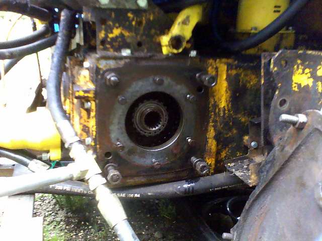

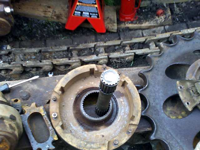

And this pic? It's a little tough to tell if you're not familiar with it. There used to be a pilot that rides in a bearing in the output shaft on the end of this shaft. Guess where it is now.
About that shaft... Got a spare one at home. Odd thing is the pilot is undercut where it joins the shaft. Looks like a designated weak spot. Got a feeling the left side is broken as well. Was thinking about drilling it and inserting a hardened dowel till I saw that. Provided I could find a fifteen millimeter dowel. Now I think I'll turn the dowel as well.

Looks like you have some of the optional "toothless" fiber discs.

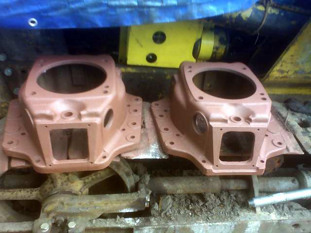

Final installment in my "strip the right side saga". As you can see I did get the steering clutch housing off. Almost talked myself out of it but after making such a noble statement 'bout being persistent...
Can I interest anyone in a slightly used vintage housing?
The secret to removing the housing is (not necessarily in order)...
1) remove the quill
2) remove the studs
3) if you got an 831 loader and that last bolt is protruding, back it off.
At this point the only thing holding the housing is two dowels. One good snatch will get it.

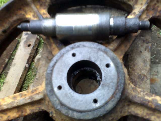

big idler problem
Post by emichaelhaynes » Tue May 01, 2007 1:16 am
Not nearly as bad as I thought. The bushing that used to reside in the bore nearest the camera is actually down in the middle. Somebody should have put a spacer in there to prevent this situation. There's nothing in the parts catalog so nobody but Deere is to blame. I'll make a single bushing to span the entire width of the hub. Have no idea how much grease is wasted filling the void in the middle of the hub. No point in finding out.

The bushing is supposed to be a fairly tight press fit, that is why no spacer. Not sure if you could build the indside of the hub up and rebore it.

Post by emichaelhaynes » Tue May 01, 2007 12:20 pm
No need to build up the hub, its round with no sign of wear. It may or may not be oversize, I'll turn a new bushing to fit. Oddly enough, the shaft has some scoring in the middle, the section that rode in the bushing shows minor wear, and the section that rode in the unbushed bore has some corrosion but no wear.

after taking off the back skidd plate, and removing the two bolts off from the back, the final drive came off nice and easy.
Right away I could see that the brake band was broken, with a piece of linkage broken, as well as the brake band.
The throw out bearing seemed to have packed it in tho, with the retaining cap screww being shorn off the bearing carrier, how ever the stud is still there.. It looked like it had been repaired before, as i could see where someone had tried to repair the cam by welding a small amount on the ends of the slots.
the clutch seemed to be in good shape, all the steel plates snd fiber disks seemed like new.

there's three pairs of cups with a ball bearing between each pair. three cups are fixed in place on the large casting every rides in the other three are in the cam. as the cam is rotated the ball bearings roll from the center of the cups toward the edges and the cam moves outward.

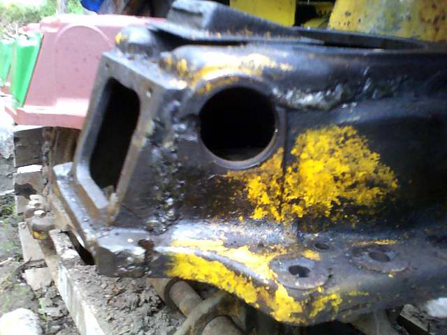

Post by frozendozer » Tue Oct 09, 2007 11:57 pm
here's some pics from my tear down, the side i thought was a clutch problem was actually a seal failure on the final drives. the result was that all the gear oil got spread over the clutch disk and brake band.
The clutch disks all look real good, after i cleaned the grease off, and iam wondering about re-using them. Would it be ok? should i replace with new?.
I know Ive got it tore down and could replace everything, but i cant really spend money where its not needed, any advice would be much appreciated.
