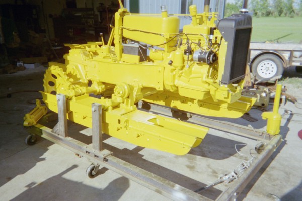

Post by Lavoy » Sun Jun 10, 2007 9:46 pm
Okay, here is a recent pic, track frames installed, and the engine runs. Tested everything for function and then took it out of the stand. Right now it is sitting on the floor waiting for the dyno to get rolled in tomorrow.

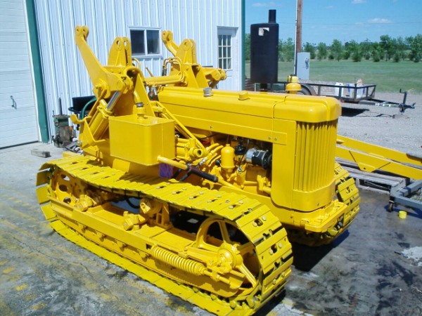

Post by Lavoy » Fri Jul 06, 2007 9:39 pm
A little more recent pic, on it's wheels, and moving under it's own power in this pic. Loader has been installed since this pic, will post more later.

Post by sbarr » Sun Jul 08, 2007 12:07 pm
Looks great,just a quick question where is the pump for the loader on it,mine is on the end of the crank and had to modify the nose for it to fit,Henry loader though,but I'm use it is the factory setup.

Post by Lavoy » Wed Jul 11, 2007 5:47 pm
The pump is in the same basic location as yours, but is a factory mounting and different grille so it all fits.

Post by Lavoy » Thu Jul 12, 2007 6:46 pm
Here is a pic with the loader and scarifier installed. Sorry I have been slow getting pics up, but not enough hours in the day.
