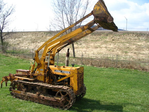

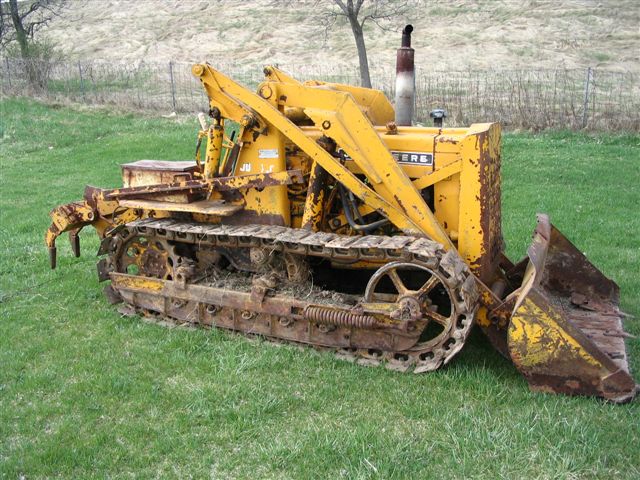

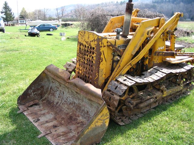

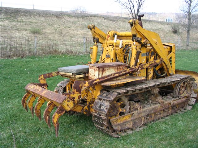

Here is my new crawler - purchased in the Fall and it will be delivered in the Spring. Pretty sure I'll need to do some undercarriage work and the steering clutches are stuck...
Hoping to get her going and use it to help restore an old apple orchard on some land I have on the St. Lawrence River in upstate New York. Love to hear your opinions on what you see in the pictures! - Chuck :-)

TI 420, believe it or not I have the same crawler. The loader is made by autocar I think. I have the same snow shoes and the scarifier. I only have three shanks, I would think having all 5 shanks is pretty rare. You will not believe the power of the loader, the front boom cylinders are extremely powerful. Awesome find and good luck! Tom.

it looks like it is a great machine to start with, how many loaders where made for tractor?

There were almost too many loaders to count, Lord, Henry, Davis, ATECO, Greenville Steel Car Company, Wagner, and a host more that I have forgotten.

Lavoy, that's it Greenville Steel Car Company, I knew it had car in it. I have broken the stops on the tilt cyclinders once or twice, acting stupid. It is a very nice loader setup. Tom

I don't remember exactly how it worked, but I think the loader on one side of the country were called ATECO, and on the other side they had the Greenville Steel Car Company name on them. All of the literature I have lists only the ATECO name as far as I remember.

Hey Guys I just happen to have an original parts, service, operators book for a Greenville Steel Car Company Hilift, Greenville Pa. About 40 mi northeast of Youngstown OH. Indicates that They were a licensed manufacturer for American Tractor Equipment Corporation AKA -- ATECO
Greenville Steel Car Co mainly manufactured Railroad Cars And I think they may have closed a few years back.

I have one question and that is the scarifier manually operated or does it hook into the hydraulics somehow?

Don, it goes up and down by hooking the side rails onto the raised pins of the bucket tilt. If you look close you can see where they hook on. Then the scarifier goes up and down with the tilt of the bucket. You scarify then unhook the scarifier and then use the loader to pick up the scarified dirt. The side bars are kind of heavy, but not too bad. It can all be done without getting off the seat. I remember one time my Dad lost one of the shanks and I looked for 3 hours to find it. Tom.

Thanks for posting the info about how the scarifier works, because I'll be honest - I was wondering that myself! It's kind of a downer, though - I was hoping that it ran off some kind of hydralics back there that I could modify to carry my bush hog... Oh well - probably not the best idea to hok the bush hog up to a ozer anyway and then just start mowing rocks - I already have done too much of that with my Ford 8N...

The steering clutches are stuck. My friend said they got them unstuck last year by just ramming the bucket up against a wall - I'm hoping we can do that again. The tracks look like they are about negative 10% - I'd like to use them as-is this Summer to lanscape the yard a little, then pull them and the idlers and rollers and throw that stuff in the truck, and bring it down home and replace the pins and freshen it all up over next Winter.
