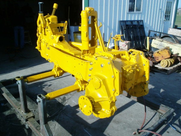

The other post was getting kind of long, so decided to start a new one.
This is a pic of the partially assembled power train sitting in the stand.

Oooh. Nice stand!
The thing is beginning to look somewhat familiar. :)

Thanks Stan. It is too hard on my shoulders to lay on the floor and work over my head with limited clearance, hence the stand. This is the first it has been used, and I need another one.

That's a great looking job Lavoy. I hope mine turns out have as good. Are those stainless bolts in the finals or do you end up painting them?

No, they are just zinc plated. I do not use unplated fasteners unless unavoidable. The fasteners will get painted when I overshoot the whole thing. I need to get a lot more parts on before I do that.
I personally do not mind the look of unpainted fasteners, but this yellow is so hard to match from piece to piece as they get painted, that another coat is the only way to make it look good.
Post by wwattson » Thu May 03, 2007 9:09 pm
I like the unpainted hardware myself. Whenever I refinish metalworking machinery, I always go with unpaint hardware. Big difference is that machine tools stay indoors and a little Boeing T9 coating goes on everything to protect against any condensation.
I'm up to the point of reassembling the major parts of my crawler and was wondering if most folks just prime the parts and finish coat when assembled or finish paint the parts and second coat everything when assembled. The coverage is sure better if you go with the later method.

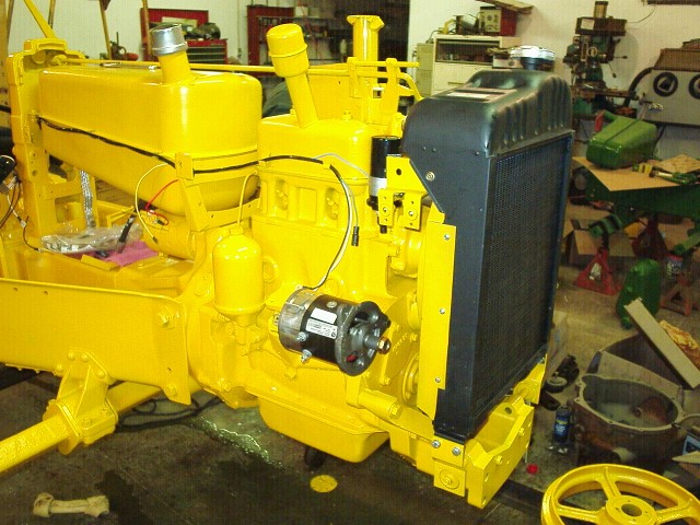

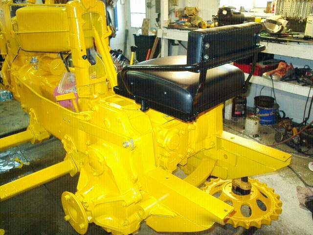

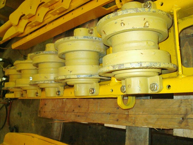

Here are some more pics.
The dash with all new gauges, light switch, tach, fuseholder, and dashlight.
Trackframe with all new sealed lifetime rollers.
New seat base, new cushions.
New radiator, rebuilt generator, new wiring harness, new coil and bracket.

Question about the Tachometer in the photo
Post by jd49mc » Tue May 29, 2007 8:27 pm
Lavoy,
Is the tach shown in the dash photo the current Deere service part? If not where is it from?
Posts: 11138
Post by Lavoy » Tue May 29, 2007 10:19 pm
No, it is a replacement tach made by Stewart Warner, I get it from a local supplier.
