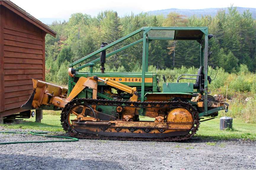

Post by emmett » Thu Sep 20, 2007 6:44 am
420C with a blade and jerry-rigged (but awesome) old army 6x6 winch.
Back on it's feet thanks to Lavoy's parts to rebuild left-side final drive.
She's got about 2000 hours on her and loves to play in the woods and play in the dirt and snow of central Vermont.

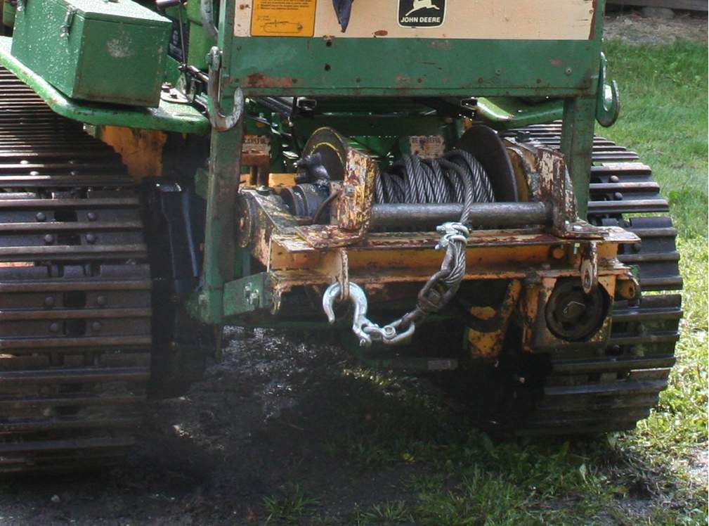

Post by NNAATZ » Thu Sep 20, 2007 9:05 am
i like it!! hows that winch drive?

Post by emmett » Sat Sep 22, 2007 4:42 am
The winch works very well.
The PTO drives a motorcycle chain link to the winch drive.
This has worked perfectly (I can't take credit... previous owner set it up).
Cable is about 100' of 5/8 cable. I actually think the cable could be 3/8 thick and still do all I need.
It only drives in the wind-up direction.
If the load won't move, it will drag the crawler back to the load with engine just idling... brakes locked and all. Very strong. I straightened out a cast-iron end-hook with it once.
The drive clutch is a castellated coupling. The weakness here is I can't disengage the drive clutch if the winch is under serious load, the friction of the clutch under load is too strong. I've had the cable taut as a piano string before... scary. No amount of grease will slip it! I just have to remember to maintain back-up room behind the crawler so I can put slack in the cable if needed. (I have got into trouble by neglecting this before. Now I use end-hooks with a cottered pin to connect to the cable leader. I can always smack the pin out to release the cable.)
The winch barrel is open, so you gotta be aware and stay safe around it. I don't even want to think about getting my A** pulled in there.
I use the winch to skid logs for firewood and to yank thankless neighbors out of the ditch. My buddy has a plow truck he can't keep on the road... If I had a dollar for every time.... :-)

Post by NNAATZ » Mon Sep 24, 2007 9:41 am
i thought about retro fitting one on to mine, what you discribed is what i was afraid of. if it was anyone but me operating it, it would be to dangerous.
i have an 9000# electric winch on a reciever mount that i use on my mud truck and have threated to make recever for the crawler but pto would be cooler to have.

emmett
Posts: 42
Joined: Sat Aug 11, 2007 7:05 am
Location: Vermont
Photo of Winch on 420C
Post by emmett » Thu Oct 04, 2007 12:33 pm
Below is a photo of the winch set-up.
Emmett
