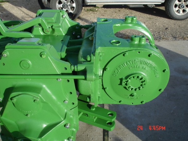

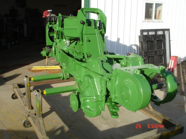

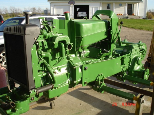

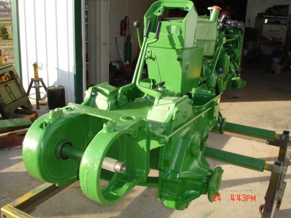

Here are a few pics of the current project in the shop. Nice to have a green one in there again.
A side view of the winch. When done it will have new bearings and seal, relined clutch bands, new brake band, new brake slave cylinder, rebuilt clutch cylinder, new hose, and a few other parts.

Nice winch
Post by Steven Walters » Sat Oct 27, 2007 8:09 pm
That is the same winch on the 420 i just got! Looking good. Steven
JD430C
Posts: 350
Location: Northfield, Vermont
Post by JD430C » Sun Oct 28, 2007 8:36 pm
that 430 is looking good lavoy. seeing that one makes me want to restore mine :). if u have trouble finding parts for the 8a pm me, there is a company in southern NH that can still get new parts for them.

nice looking tractor
Post by mini kahuna » Mon Oct 29, 2007 1:32 pm
Lavoy,you guys amaze me with the care and effort you put into these machines,awesome job,going look better than when it came off the line at the deere plant!!

Post by mailtrain@usadatanet.net » Mon Oct 29, 2007 5:44 pm
Looks good Lavoy, Below the insturment panel under the choke button there is a cut out, is there a reason for this.My 430c has the same cut out.I thought someone had broken a piece out. Dean
Posts: 11149
Post by Lavoy » Tue Oct 30, 2007 8:44 am
That is where the suction line and pressure line for the hyd runs on a wheel tractor. It has not function other than the taillight harness on a crawler.

Lavoy, about that frame holding the tractor. How about some details?? I have at least 2 I'm going to work on and if I can get the 3rd one past the wife :lol: :lol: ??
The 420 has had pieces welded on the end of the bars, no holes now, so I think I would want to go with saddles instead. Also the 40 doesn't have any taped holes on the front bar.
I've already looked at some casters rated at 1000 ea. I noticed from the photos that one bracket is gusseted and the other can be moved. Is the cross frame adj??
What would you change?? There is usually something that you notice AFTER you build that you would do differently.
Gus
Posts: 11149
Post by Lavoy » Tue Oct 30, 2007 10:13 pm
Gus,
The frame underneath is I-beam, the uprights box tubing. The front one is adjustable so it is easier to mount the frame and crossbars in, plus, for an MC or 40, I would make a different front mount that is more of a saddle.
Part of the reason I did not go all saddle, is I hoped that by bolting the uprights rigidly to the crossbars, I would get a little more rigidity in case some idiot bumped it with the forklift. :lol: If you make it with saddles, make sure you can clamp the crossbar rigid, otherwise you could up end the unit if you hang both finals without an engine on the front, or vice-versa.
Not a lot I would change I guess so far, maybe brakes on a couple of the casters. I plan on putting some square tubing under each end to put the forks in when moving it around.

Last night I was thinking of an H frame so I could get my engine lift in to remove heavy parts. That or make the frame high enough to let the lift go under it. The outside frame, as you have, would allow easier track work.
The engine lift is the only thing I have to work with so it needs to be able to reach all parts.
Gus

Gus,
Most engine hoists will fit underneath my frame on all sides, so you would still have access. If not, go to larger casters to get the frame off the floor more.

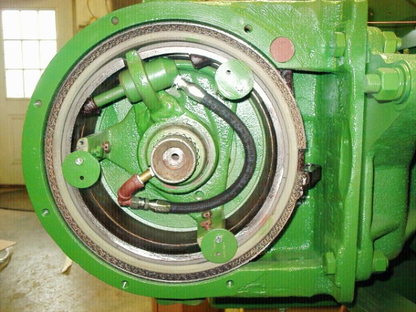

a new pic of the winch
Post by Lavoy » Tue Nov 06, 2007 5:32 pm
Here is a pic of the winch with the relined clutch bands, new brake band, and hose installed.
