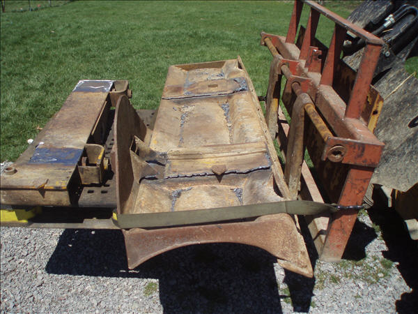

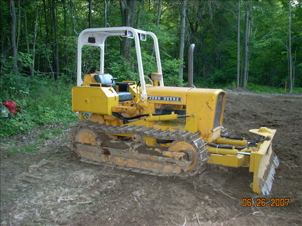

I bought this 350 about 1 1/2 years ago to some work around my property but I couldn't just leave it alone. Here is a picture of it when delivered.

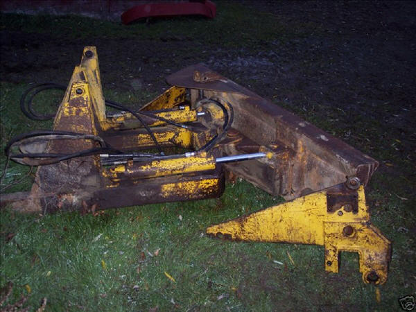

I then found a 6-way power blade assembly from a dozer someone was scrapping the angle cylinders had holes rubbed through. I am guessing the spacers were not on the dozer it came off of.

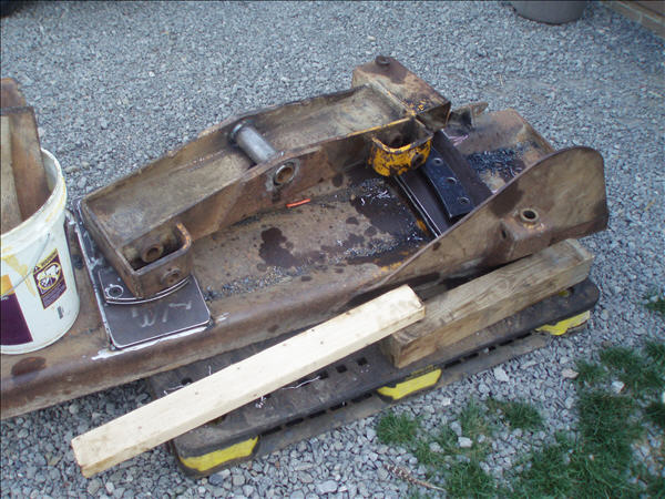

I rebuilt these with parts from Bailey's. I also remade parts for the tilt movement. I made a version with bolt on plates the facilitate easy replacement. This a picture of what I burned off.

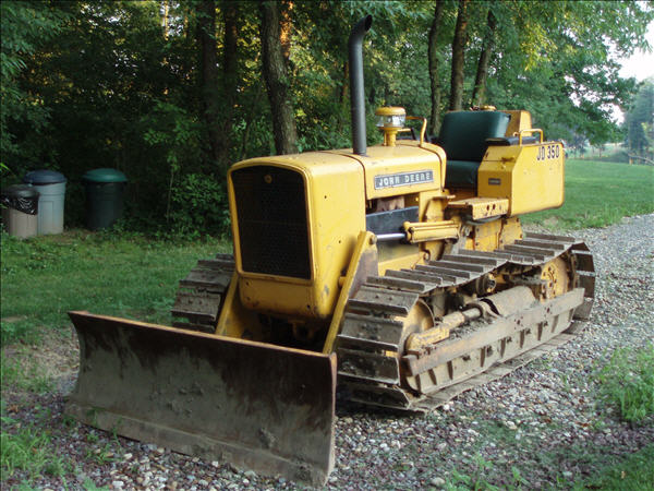

And finally a picture of how it sits today. I still need to paint the canopy it just has primer.
