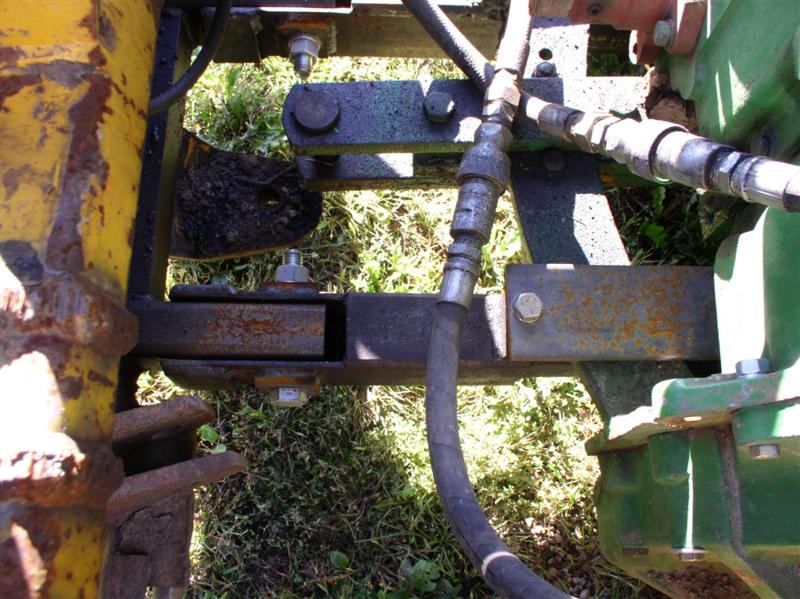

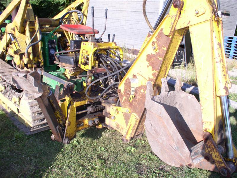

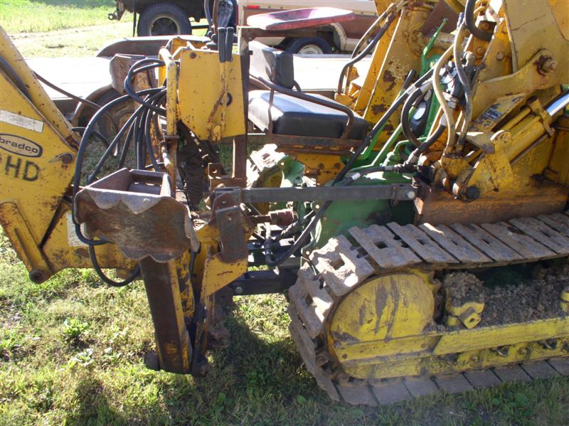

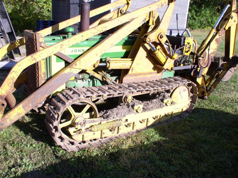

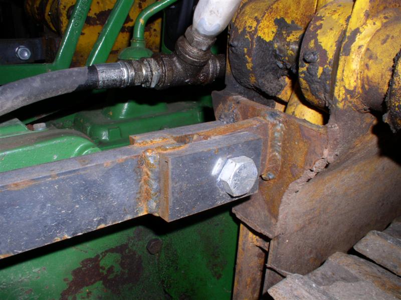

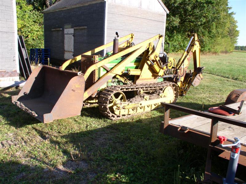

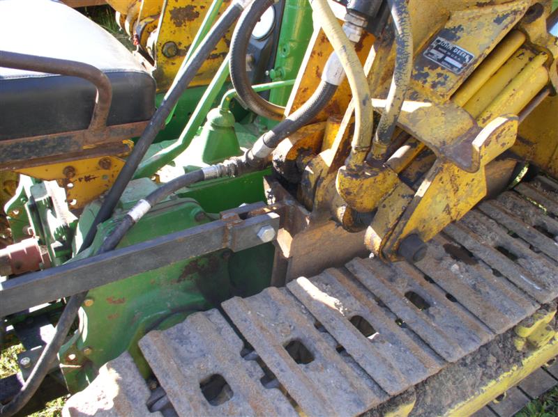

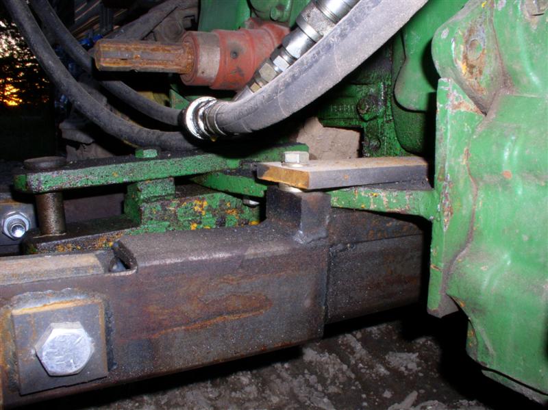

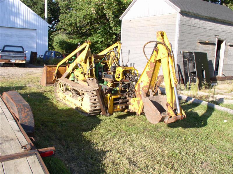

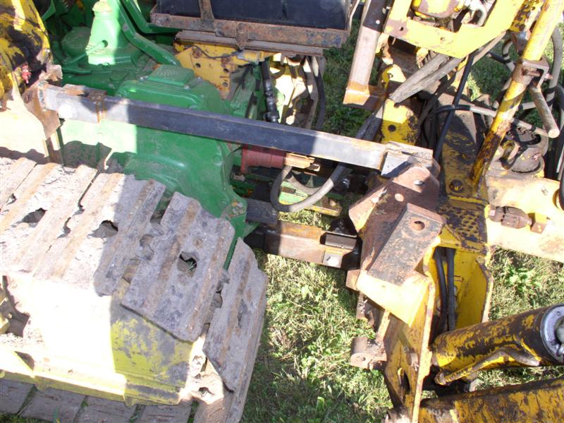

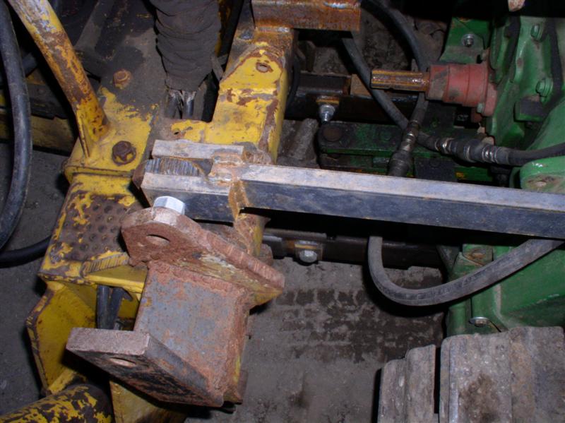

i don't know what happen there, but here it is my 420 with a pto and also have a JD blade and forks for the loader. i have had this for about 4 years now, it is used on a daily bases.

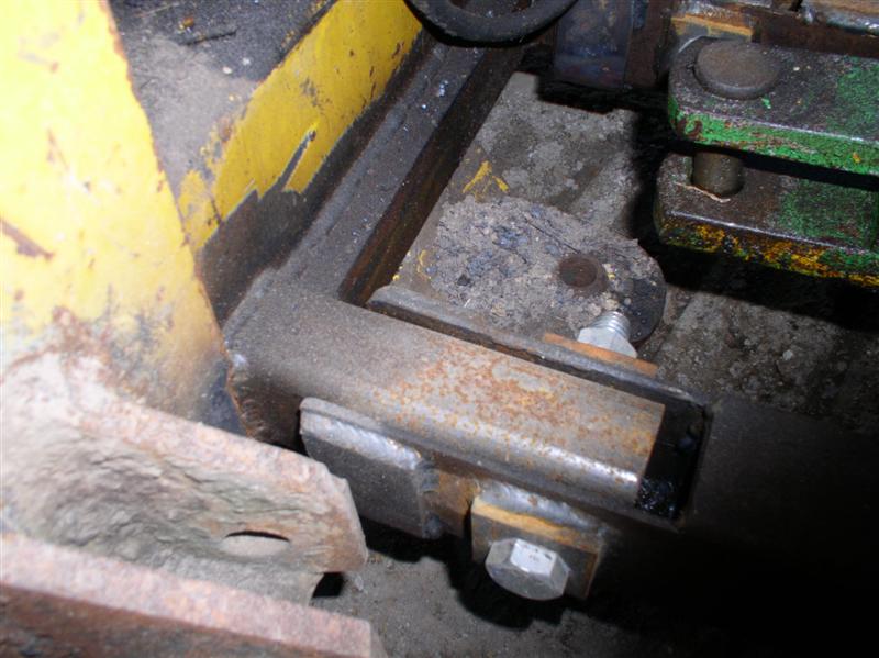

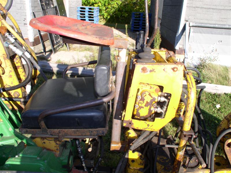

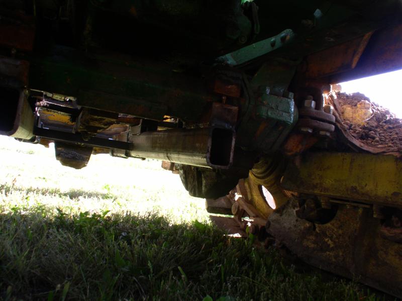

i have been meaning to finish my post, i believe it is a 1956, there is no serial tag but it was all yellow originally. the loader is a model 90 and have the weight and weight brackets for the rear. the pto i had added for mowing ditches and soggy ground. i also have made a 3 point for it and now in process of building a pull type hydraulic scraper. the hoe is a bradco, it had had been made to fit many different tractors over the years that is why there is extra brackets on it, soon to be gas axed off. i dont know what the lifting cap. of the loader is, but it is more than my other tractors. i have picked up better than 4k with it. it has been a great machine for me.

Good pics,any idea what the hoe alone weighs? I am putting a hoe off a Case 530CK tractor on mine,just hope it isn't too heavy,think it is around 2500lbs. All the sub frame is made up,similar to what yours is,all mounted off the crossbars and loader framework,all I have left to do is the lines,mine will work without using a divertor valve,the valve body that the Henry loaders used were set up for rear hydraulic setups,like a backhoe ,woodsplitter,etc

i am guessing right around 1500#
