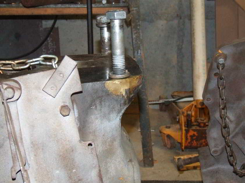

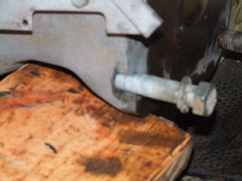

I tried my hand at brazing cast iron this weekend. I did some research and found that you need to pre-heat the part to around 500 degrees before making the repair. So I dropped my case into a 30 gal. drum and heated with my propane burner. Took about an hour and a half to get it up to temp. Made the repair then wrapped it in an asbestos blanket and let it cool over night. The next day I drilled and tapped the hole. I figure if it held up to tapping it should be O.K. Here's a couple of pics.

Post by JD440ICD2006 » Tue Jan 20, 2009 3:46 pm
You do good work. You will never know it has been repaired when the paint goes on!

Posts: 11148
Post by Lavoy » Mon Jan 26, 2009 9:02 am
Craig,
The one thing I would suggest is to use the longest bolt possible, so it goes all the way in to the bottom of the original threads.
CAR
Posts: 50
Joined: Mon Apr 07, 2008 12:25 pm
Location: Georgia
Post by CAR » Mon Jan 26, 2009 9:52 pm
Lavoy,
I had about 4 maybe 5 good threads at the bottom, I'll have to measure but I think the bolt that's in there now will do the trick.
