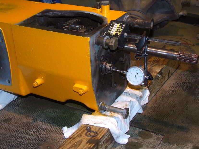

After repairing the transmission case, I inspected and installed all components back into the transmission. Someone had gone through it before and most of the bearings and cups had little if any wear, however I did have to replace some bearings and cups, I also bought new shim packs and replaced them. It was easy to see where they stopped. This machine was well taken care of.
Setting the preload on the bearings with dial indicator.

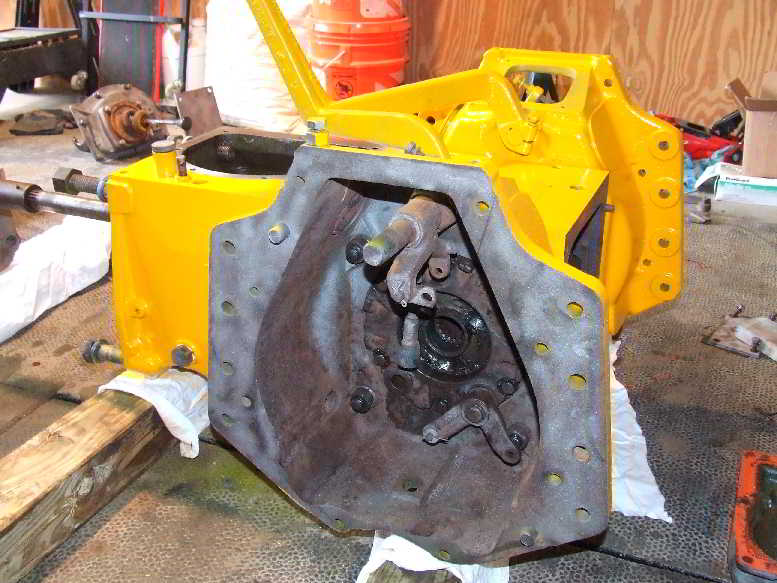

I painted these parts with the dreaded spray bomb, I wanted to get some paint on them before assembly, I plan on shooting the whole thing when I get more put together.
Steering clutch housings bolted in place,
Need to clean the paint off some of the surfaces before assembly.
