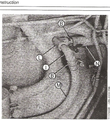

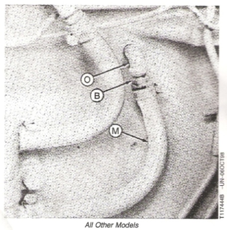

Post by CatD8RII » Fri Sep 05, 2008 7:27 pm
I was refering to moving the upper hose down off of the thermostat to the block. There isnt alot of room in a 350, especially if its a loader. Pictures are better than words. Sorry about the clarity ,there a scan of the JD install manual that comes with the heater.
jdemaris
Post by jdemaris » Fri Sep 05, 2008 7:41 pm
CatD8RII wrote:I was refering to moving the upper hose down off of the thermostat to the block. There isnt alot of room in a 350, especially if its a loader. Pictures are better than words. Sorry about the clarity ,there a scan of the JD install manual that comes with the heater.
I've put plenty of tank heaters into 350 crawlers - dozers and loaders, so I know it can be done as I mentioned without major problems. That being said - in regard to the hookup that you're showing? It still has to work, just not as efficiently. Your hookup takes coolant from the bottom - and sends it half-way up - instead of sending it to the top. All that counts is that the coolant circulate with some sort of top-to-bottom temperature differential to create a thermo-siphon flow. With your hook-up, I suspect the thermostat will shut the heater off and on a bit before it does it's job- that's all. Since the hot water rises, the entire engine will heat up regardless.
