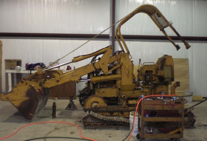

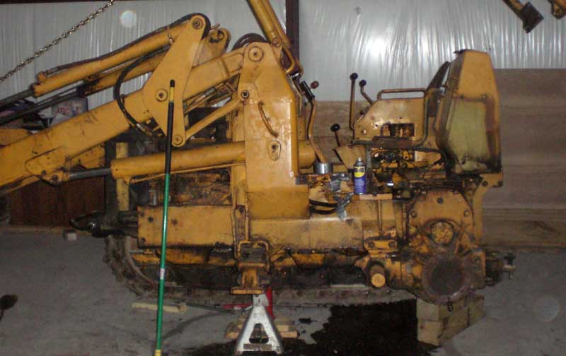

My father and I recently purchased a 72 350BB. This is my first machine. It seems to be in pretty fair condition, I drove it onto the trailer and then pulled it from Florida to my house in Texas. I'm almost certain the left clutch needs to be re-built. Pulling the lever will stop the machine, so I'm guessing that means its not releasing the clutch. After reading a few threads on here I pulled up to a rock pile and worked it for a little while trying to free it up...no success. I pulled it into our shop, and after looking at it for a few minutes began pulling stuff off that looked like it would be in the way. A case of beer later (texas time for 4-5 hours) I had taken essentially the entire left drive assembly off...track, sprocket, track frame, ROPS....I haven't exposed the clutch yet, maybe tonight. I also noticed that the master cylinder looking device for the left lever is leaking pretty bad. I have also taken the front clip off in order to expose a pretty bad leak at the hydro pump. So far have have managed to do all this with just basic tools and a couple pry bars and wood blocks...no injury's yet from all the very heavy pieces. (I graduated college in may and just moved to texas so I'm almost tapped out in the bank and don't have any fancy tools or lifts). At this point my main question is where can I get parts for a good price ?
The parts I know for sure I need at this point are (all on the left side): clutch plates, at least one roller, and track adjuster, maybe a seat but I might just make one.

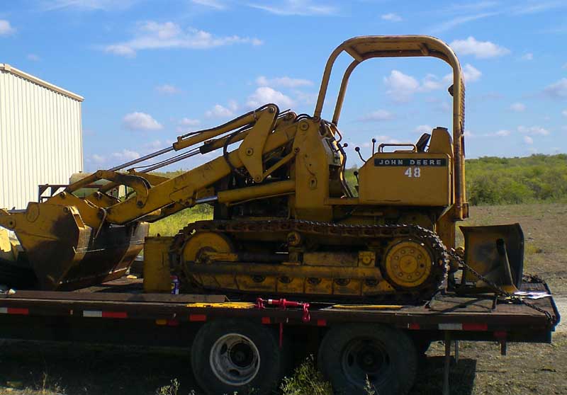

Here are a couple pictures of my first step to addiction. Comment on anything I want to know where I stand.
My 12 year old niece steam cleaned it before I started getting into the fun.
Sitting on the trailer after the 1200 mile trip
I feel like I might be jumping in the shallow end head first
Calling it quits at 11pm....not bad for a rookie and 4-5 ours

Allmost identical to my supposed 450A
Except the mine has top links for the loader curl.
Yours has under links.
Oh a great pics. Thanks

Thanks "underdog" nice 450, I can't wait to get this one done and do a couple jobs to pay it off so I can upgrade to a larger one. I see they made some improvements to the track frame on yours, it extends to encumpus the drive sprocket. Great picture though she looks great.

Well after doing a field repair on my hand (should of got a few stiches, but super glue seems to be holding it together well) I was able to make some more progress on the machine. I made a support system with a floor jack and some lumber and had the final drive off in about 15 minutes. Looks like the brake band needs to be re-lined but everything else seems to be fine. Now on to removing the throwout bearing and final drive casing so I can get this thing fixed and put it to work.
