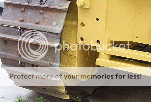

On my 450c located toward the back of the track. There is a large plug mounted on the wall of the dozer houseing. From looking at the maintenance manual, it did not show this. So I assumed it was the fill port for the wet brake assembly. I unscrewed the level plug ( Located on the back side of the houseing) and started to put in 2 plus gallons of 80w90 oil and nothing ever came out.
As I said earlier, my manual does not show this, so I'm at a loss of what this plug is for? Hope someone can help.
Both left and right of the dozer has the same plugs mounted on the side of the houseing, just above the brake assemblies.
Also, its a 1975 450cc dozer.

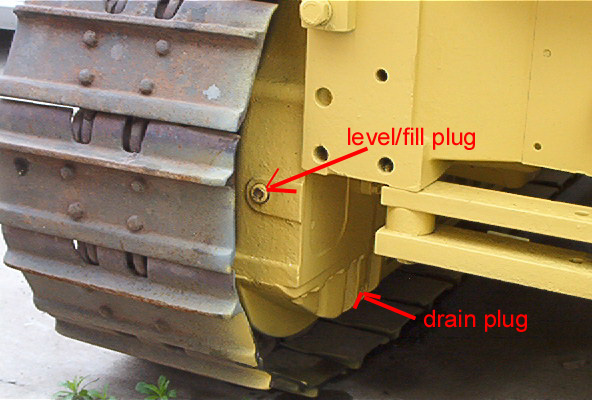

I've attached a copy of your picture with the correct location of the final drive fill/level plug indicated; note that it is on the REAR of the housing - I hope it comes through ok...
The plug on the OUTSIDE of the housing in the angled hole, shown in your first picture (IM002021.jpg), is NOT the correct place to fill the final drive... it is the access point to a set screw that is used to disassemble the final drive pinion.
The correct oil to use in the final drives is JD HyGard Transmission and Hydraulic Oil (J20A) or an equivalent available from any major oil distributor... it is, in fact, the ONLY oil, other than the engine oil in the motor, that is used in the 350 & 450 series machines... in other words you use it for everything.
...on edit: I should add that if you did dump the 80/90 into the wrong hole it most likely ended up in your steering clutch housings... I'd get it out of there if it was mine.
