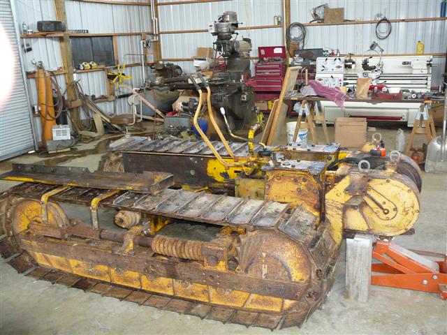

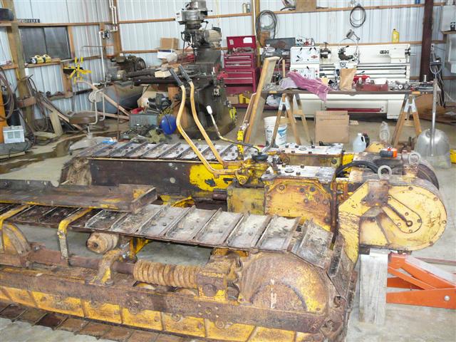

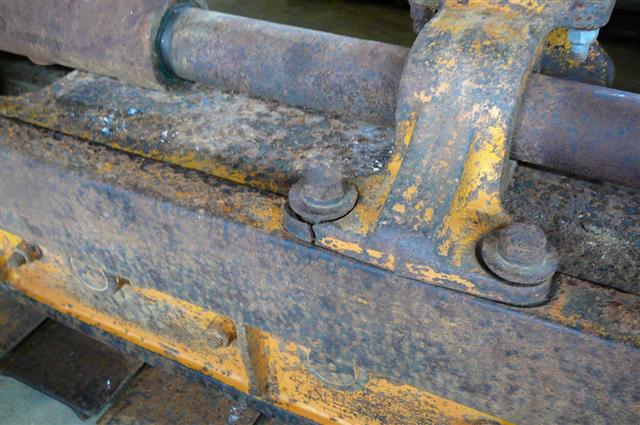

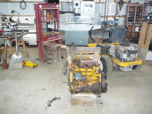

The first pic is of the clutch valve lever. You can see it has a recessed area on one side. Is that supposed to be there or is it worn that much from the pin? If it is wear, I will weld it up and mill it back down smooth. The next pic are just showing whats left of the ole girl. Can't wait to get her fixed, painted and everything tight. It will be nice to run a tight machine.
Nice looking shop at least, I'm impressed. Is that a lathe and two milling machines? Looks like a fun job on the crawler.

Bryce, yes, I have an old Bridgeport, a tormach CNC and a shopfox 13x40 lathe. I am by no means a machinest but like playing around with them. The Bridgeport was given to me by my uncle who has two machine shops full of CNC equipment. I bought the Tormach because it was a great deal off Ebay. I just recently bought the lathe to replace an old Atlas lathe my uncle had given me. For many years, the only place I had to work on stuff was in an old run down chicken house with a dirt floor. About five years ago I finally built a 40 x 60 shop and now my wife says says I should just move my bed out there because I spend so much time out there. It's just nice to be able to drop a nut on the floor and not have have a shovel to find it. The pictures don't show it, but at the other end is the wood shop with all the saws, planer, CNC router table and all the other junk I can cram in there. When I built the shop, I thought a 40 x 60 would be plenty of room, but it filled up very fast. Anyways, thanks for the compliment.
